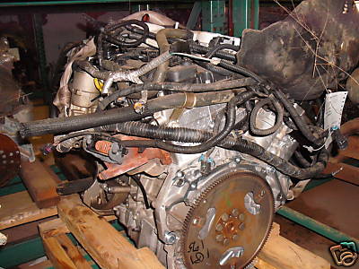

      I'm pretty sure the high feature V6's like the one from a 3.6 Cadillac CTS in the attached image is a different bolt pattern.
        Hmm... perhaps you are right. I could have sworn it used the same pattern, but the more I search, the more I am leaning towards a different bolt pattern.
