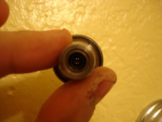

    yep not sure the angle when they spray, but the ports on the tip are kinda like this ( : : ) and a normal injector like the l67 are like this ( :: )
    hope that helps answer your question

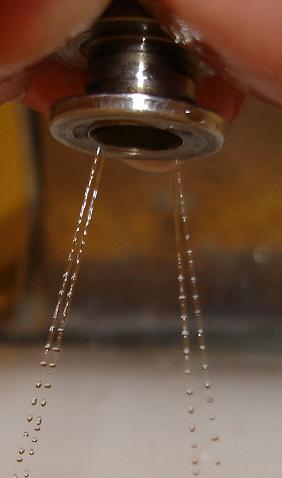

      Ok, I was curious, and did some research. I cut open an old injector. Forced water through it, took a picture of the spray pattern...
      The result was, Yes, they are split pattern, the pattern is 19 degrees from jet to jet.
      Interesting observations.
        Now I'm just curious what result that would have on horsepower..... specifically using a "normal" cone injector where there once was a split spray.
