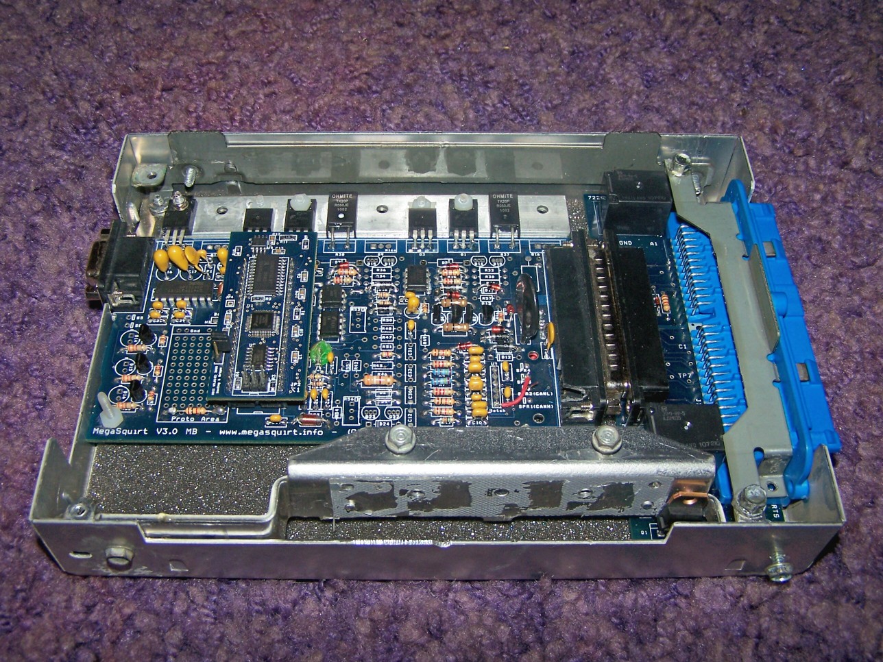

          3.1/3100 small port hybrid. With 3.1 RWD pistons, giving 11.44:1 CR. Stock cam. Figured it would be better to get a stock baseline down before trying to break in a cam.
          Most of the issues were with the MegaSquirt II ECM I was using.
          1. No IAC control. Not automatic, anyways. Manual control was just fine. I figure on a bug in the code somewhere.
          2. Knock sense useless. The signal was apparently somehow tied into the TPS and MAP readings. Signal curve matched TPS and MAP readings exactly, making knock retard useless.
          3. Metric ton of sensor signal noise.
          4. When I would put a setting into the MSII, eventually it would have to be completely rebooted and reflashed with working restore point. For whatever reason, it would lose settings and go nuts after a while.
          5. MSIIExtra DID NOT WORK whatsoever. I paid a guy $100 to remote tune the thing. He practically INSISTED I use MSIIExtra even AFTER I flat out told him that, A, I already had a running tune that just needed tweaking, and B, I had already tried Extra and it did NOT work. I still want my money back from the guy. He completely screwed up the ignition curves and didn't do crap with the fueling table, which is where it needed help.
          6. Bosch/Ford 22lb fuel injectors would not work properly with MSII. Kept running super rich when hot. GM Multitec injectors from a 350 did NOT have this issue with the same code.
          7. Autotune in the Tuner Studio program did not work. Period. Kept trying to tell me the "O2S Out of Range" when it was using a wideband O2S and it knew the AFR and what it was supposed to be. And wouldn't do a thing. With the AFR less than one full point off.
          8. The people on the MS forums were as helpful as a horde of zombies. Kept asking the same questions over and over when I would continually bring up the same issues over and over on the same MSII code version and same Tuner Studio version and didn't come up with any useful solutions (actually, NO solutions whatsoever but I digress).

              Knock control only required one wire physically on the MS board. However, I did buy a $13 expansion board and parts to connect MS directly into my wiring harness without modifications to the harness. Only modifying I did to the harness was to add a wire for a GM MAP sensor and a wire for the knock module running to the MS.
              That thing was great until the malfunctions started over and over again. Even down 2 cylinders I could still lay down rubber if I wanted to. I don't think I'll ever find out why the IAC control never worked automatically or just what was up with the knock sense. Especially since a good 2/3 of the time the engine was running overly RICH, according to my wideband.
