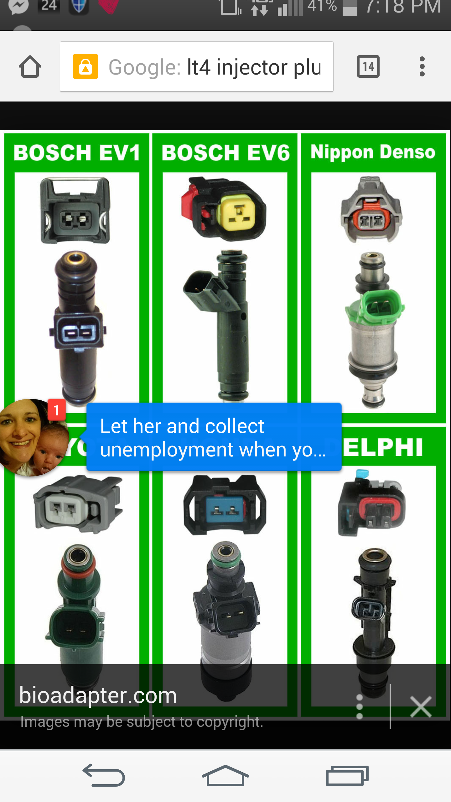

    Do they have the same connectors on them?
    • #32
      I believe they are EV1, along with pretty much all LS injectors. I have a set of your interested. I just bought some LS EV1 injectors for my 01 V6 and bought delphi to EV1 adapters. If you need any help with anything let me know. I have become quite versed. I also have almost everything needed for a 3.4/3400/3500 hybrid of you wanted to go that route. Selling it cheap! 6166445482

        So almost all ls1 injectors use the ev1 connecters? The stock 3400 injectors are delphi connectors right? So if I went with EV1 I'd need that adapter?
        • #34
          Correct mostly, all LT1 are EV1 and some LS1, depending on vehicle some were different. Like the corvettei think are EV6 for the newer years. Here's a pic of the differences and a link for adapters. http://www.casperselectronics.com/st...x.php?cPath=14 ATTACH]8391[/ATTACH]

            I'm pretty sure most LS injectors ate Mikey multech II plugs
            '86 Fiero, 3500, 4-speed
            • #36
              The ones I just got are EV1
              Sent from my Verizon LG G3 sexiness via tapatalk
