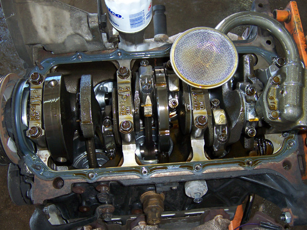

Obviously, Remove the Oil Pan.
![](http://www.domesticcrew.com/colin/oil_mods/31bottomend.jpg)
Remove the Oil Pump from the main cap.
Now the Windage Tray attaches to the engine via the Main cap bolts. on our GEN2 blocks, we just have normal main bolts,
![](http://www.domesticcrew.com/colin/oil_mods/31bottomend_2.jpg)

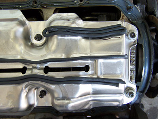

Now take your new Tray (make sure all the parts you are putting in are clean eh) and slap it into place like so:
![](http://www.domesticcrew.com/colin/oil_mods/windagetray1.jpg)
If you try now and install your Oil pan, you will soon see there are a few areas of clearance issues:
the tray sticks out too far past the front block rail's and hits the pan here:
![](http://www.domesticcrew.com/colin/oil_mods/windagetray2.jpg)
tray sticks out too far and hits the side of the pan:
![](http://www.domesticcrew.com/colin/oil_mods/windagetray3.jpg)

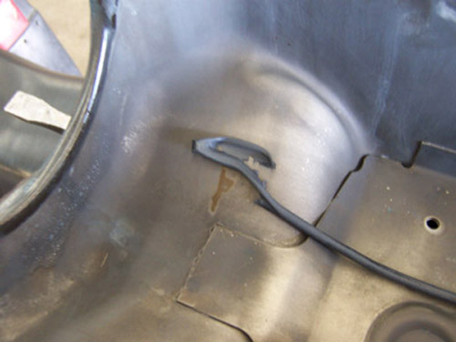

tray covers the hole for the dipstick here and forces it to bend out of the way, this just doesn't work. you will have to clearance for the stick:
![](http://www.domesticcrew.com/colin/oil_mods/windagemod2.jpg)

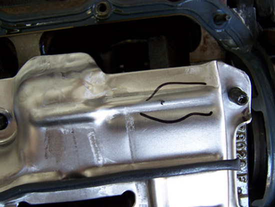

Take a marker and mark out the area's that need to be cut:
![](http://www.domesticcrew.com/colin/oil_mods/windagemod1.jpg)
Remove the Tray, Take a Die Grinder and cutoff wheel, Or Jigsaw and metal blade or whatever you have to use to cut, and Trim the area's of issue.

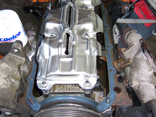

Test fit the tray again, make sure everything fits around the pan, Make sure the dip stick can fit past the tray, ect.
Should now look like this:
![](http://www.domesticcrew.com/colin/oil_mods/modifiedtray4.jpg)

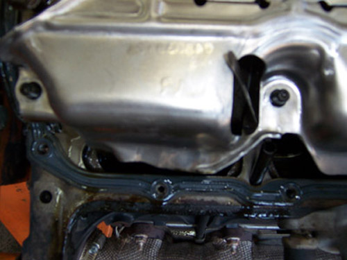

Now that the pan can fit over the tray you will soon find you have one more clearance issue, the Pan hits the tray and wont fit down far enough to bolt up properly, there is a spot where the front of our pans where there just insn't enough clearance between the two,
![](http://www.domesticcrew.com/colin/oil_mods/panclearance2.jpg)

Test fit again. and then as long as everything is good, Torque in your new windage tray: 18 Lb. Ft (25 N.m)
Reinstall your Oil Pump: 30 Lb. Ft. (41 N.m)
![](http://www.domesticcrew.com/colin/oil_mods/modifiedtray1.jpg)
