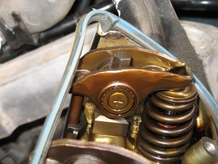

A few questions about a 3400 3500 top end swap on a 96 GA 3100. First, a newbie ? Can someone confirm that the rockers in the pic are roller rockers? I’ve searched a lot on this but I’m still a little confused!! 2. I’ve heard that a 97-99 minivan manifold will have the screw in connecter for the coolant line behind the tstat.. True?? 3. I want to get a 180* tstat. Do I need to get a 3400 specific to fit the manifold, or are they the same? 4. I have the 62mm TB from rsm. Will the adapter from the 60v6 store work? I've researched quite a bit. Just want to confirm a few things before I order parts!!! Thanks

1. Yes, they are roller rockers.
