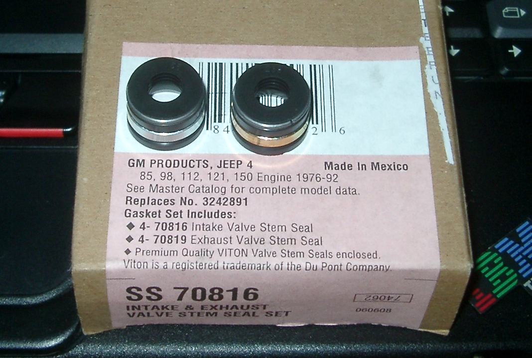

                              Those look the same size. Odd, do all the seals in that package look the same? See the pic below (click on it for high resolution). The seals in the package I have are entirely different visually:

                                Oh, too funny. I just noticed the box of seals you have. Those are entirely different seals Two different part numbers, 4 of each. So, did you buy 2 boxes or something?
                                The 70819 seal was my problematic one. It easily stretches out with just the caliper, so I can only give a min/max range. The measurement range is .480 - .540. That (almost brass colored) band around the seal does not seem to do the trick very well. The one that held on good is .475 - .520. It has the same type of band (only silver), however, the actual seal size is definitely smaller.
