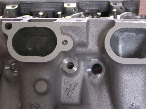

    Does RSM tell you to clean the parts before installing them? They should, because I have removed aluminum dust from both a lower and upper ported 3400 intake manifold set. It is not safe to run these manifolds on your motor as they come from RSM.
    My finger, as clean as it gets
    My finger, going into the RSM plenum port.
    Uh oh, thats not very clean
    Im taking some measurements now. Ive known this from their own site pictures, but now that I have a set here im going to check them out competely. Id really like to see them backup their flow gains since they only gasket match, and that gasket match is good for about .005" depth into the ports before they start shrinking back down to stock size.
    The TB port was ported to match their 62mm TB. I hope their TB isn't perfectly round to match their non round plenum hole. Granted, I wouldn't care so much about it not being a perfect circle since its hand ported, but its 62.9mm across one way, and 61.5mm across another section.

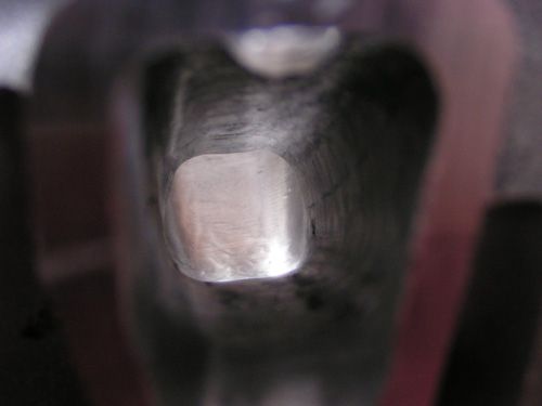

    Forget the obvious bump, thats GM casting. Check the bottom side of the port, you can see its not opened up all the way down.

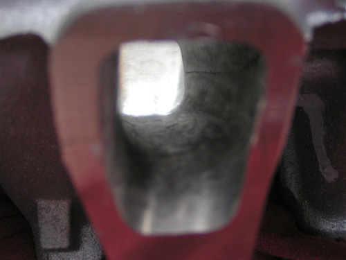

    Again, check the shape from the port entrance down to inside the port
    I locked the gauge at the port width 1/4" inside the TB opening. Yes, you are looking at 11mm difference.

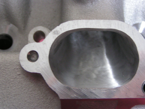

              For comparison pics, Here is what I do to a LIM for "Porting"
              I charge 150$ for that. (I feel bad having to charge that much, but its a pain in the ass, long process to get them smooth)
              I can't imagine how much they'd charge to do the whole port of a LIM (yes I get in and smooth the whole ports and gasket match the port entry/exits) as they probably charge double that for just the gasket match of the entry. LOL
