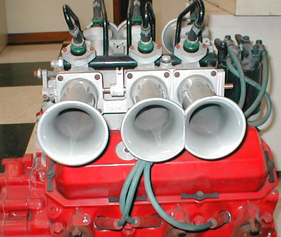

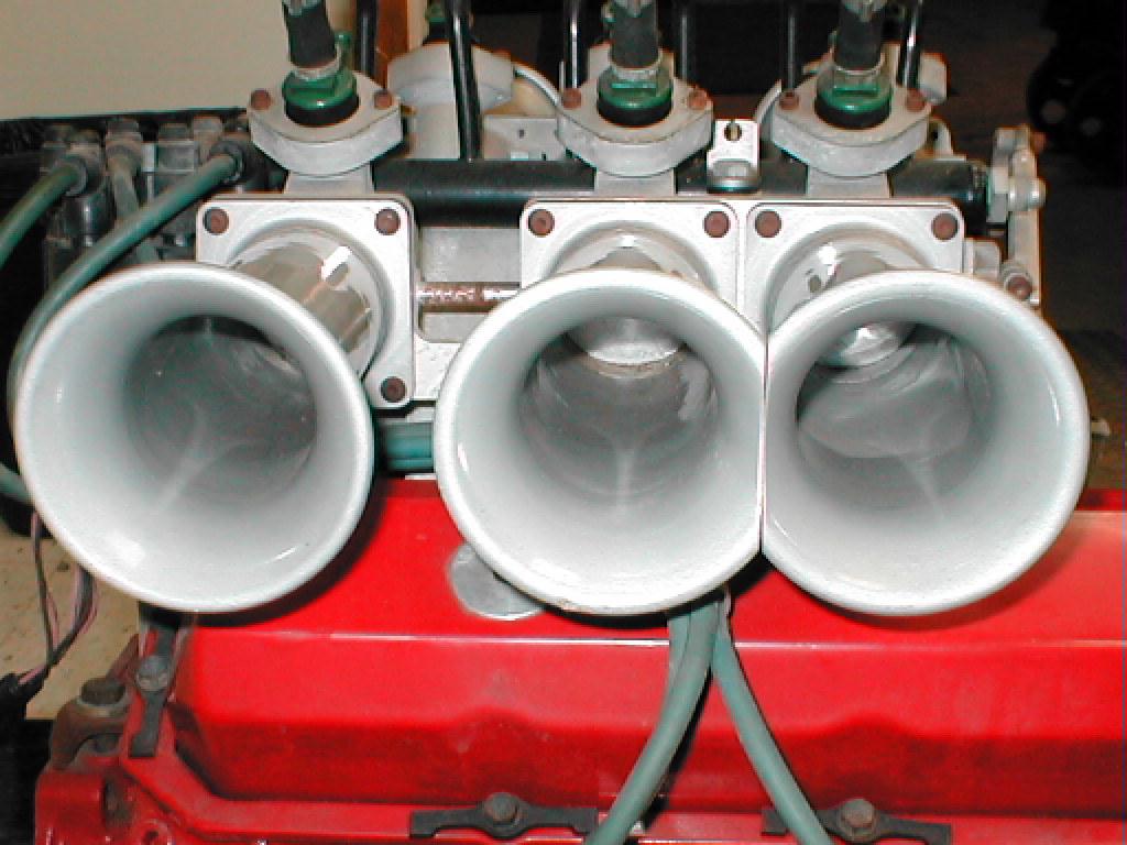

                                Not sure on the pushrod cooling passages, the the DOHC cam ones work like this. The collant flows up the enigne, but once to the lower intake, it is blocked off. The only part of the lower intake that coolant flows through is the driver's side part, coming form a single passage from each bank of cylinders. The two passages join in the LIM, then exit as one. When I built my flanges, I used a section of the factory lower intake, with the only coolant ports, that houses the T-stat, and cut it off of the rest of the LIM. This made it pretty easy. Then I just built flanges to use in place for the rest of the LIM that I cut off.
                                Since the secret is out, we all know that I am Aaron. Big deal, we shall see...Anyways, I think it will benefit you greatly to show some more pics of mine, so here you go:
                                I hope this helps. Keep in mind they are sitting on a block of wood, I havn't yet built the runners that curve into the head. For this I will be using 2" mandrel bent steel.
