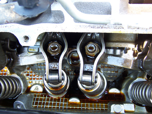

            I am literally in the middle of the swap right now. I can't manage to get the stock spring seats / seal thing off, any suggestions for this? (Not meaning to threadjack, but I feel it would be appropriate to address this in a thread about such a swap.)
              Do you use the same components I listed except for the LS6 springs?
                Yeah, that's exactly right, everything is the same except the springs, which are the same size, only stiffer. You can't get the LS6 springs from gmpartsdirect anymore, but you can get the LS2 springs which are the exact same, only with a different part number. I'm currently installing a set on my 2000 3400. I can verify the chrysler valve seals are a perfect fit (like there was any doubt). And the spring seats should fit fine after a good grinding. The seats I got were hardened and my drill couldn't touch them, so I have to get a grinding stone. From my measurements, it appears to be actually a little less than 9/16" that it has to be ground to. I will be able to verify this last part in a few days.

                            can someone post a pic of a seat? and what how much grinding is involved. and how precise does it ahve to be.
                            i'm sure i can take the seats to a machine shop and have it grinded?
