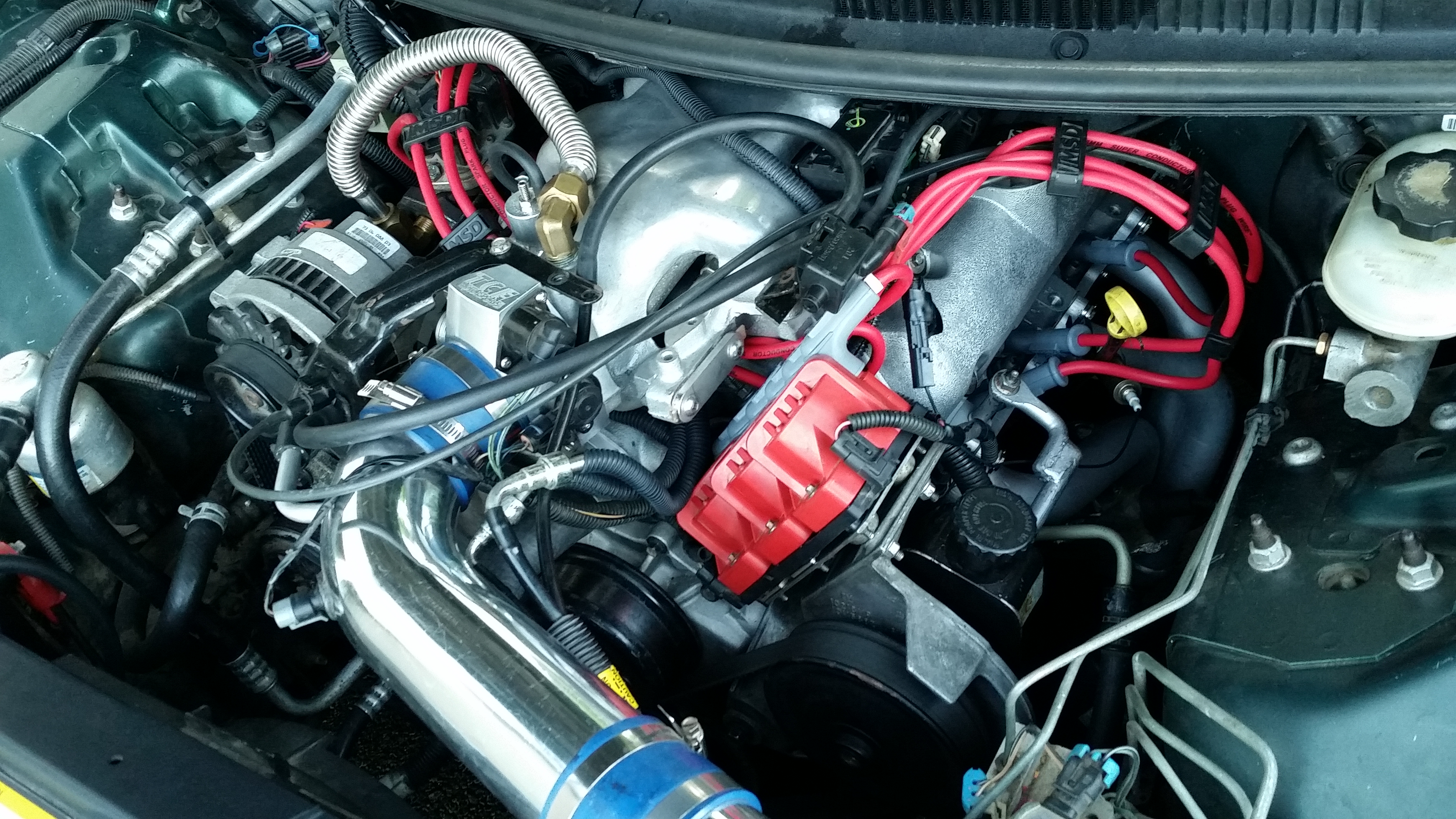

        3.4/3500
        I have a 3.4/3500 with the 3400 pistons running off an adjusted 3100 tune. It runs really good, but I'm still within the 500 mile engine breakin period so I haven't completely opened her up yet.
        Let me know if you need help. I plan on doing a thread sometime soon detailing every single part number and modification that is needed to do the 3.4/3500 hybrid. I've just been busy with school.
        One piece of advice I can give you is to buy an adjustable pushrod length checker(got mine from comp cam) and use that to measure your pushrod length on the intake and exhaust valves. It's very easy to do, but if you don't know how then let me know and I can help you out!
