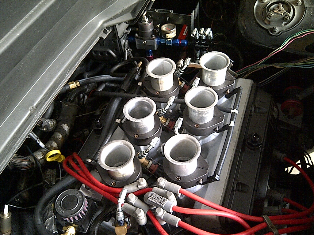

I did an ITB setup on a lx9 bottom end. All custom.
I thought the lz4 fit, flow more and had the same size throttle body? Your throttle body set up is very cool

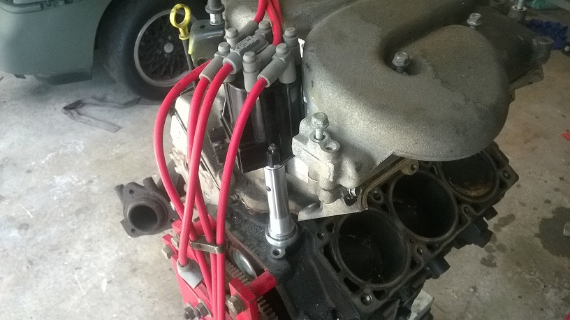

A modified distributor with a longer shaft will clear the lz9 upper intake wiith a smidge of grinding on the intake. I modified this one and it does work and the engine runs. I tested it. A stock dizzy won't clear the lower intake as it interferes with the runner.
it will not clear the lz4 though without cutting and welding of the lz4.

Thats more than enough without the custom made itb intake. Trust me its way more work and money and time then you want to put into it. KISS. You ssaid this is for your daughter. make it simple for her to wrench on.
On top of that, if you do end up putting a blower on it later for yourself, making a custom plenum to mount to an itb intake is going to be a pain. I say forget the itbs
