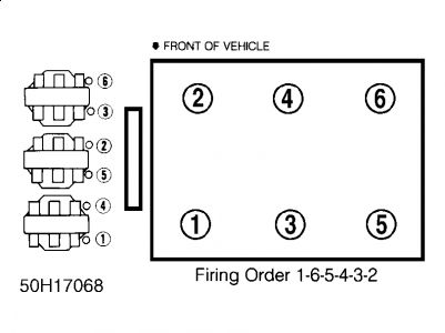

    that's a 3800 firing order/cylinder identification diagram.
    and that is the 60V6 diagram.
    note that even with the cylinder numbering accounted for, things happen in a different direction on a 60V6 vs a 3800. 60V6 fires from left to right, 3800 fires from right to left(with the exception of starting with cylinder 1).
