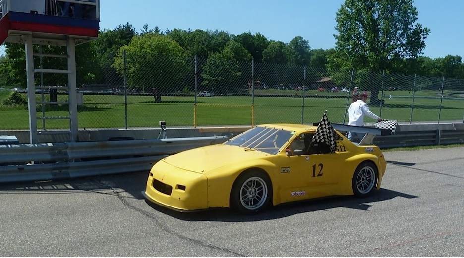

                  And here is a picture of the race car.
