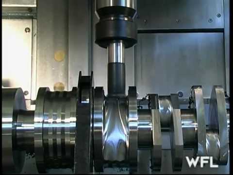

    FWIW here is a vid of a company making a Billet crank... pretty neat machining process and a crazy CNC machine.
