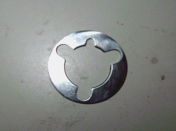

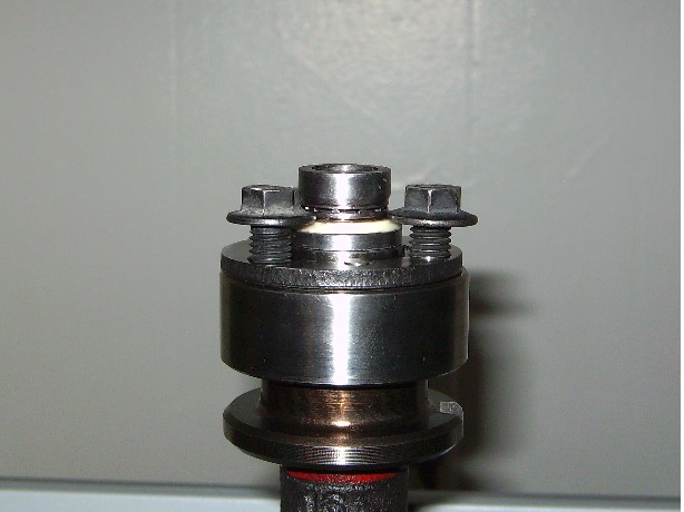

      I PM'd bl85c on thirdgen.org and got this:
      Others have done it to roller blocks using the same method. The chain's been perfect since I did it, just make sure the sprocket is centered properly when you do it because the locating dowel just barely sticks out far enough to locate the sprocket. Pushing up lightly on the sprocket with the chain on when you tighten the bolts will do it.
      Quote:
      Originally Posted by caffeine
      I saw in one of your threads that you installed a Cloyes DRTC with a roller cam in one of your engines. I had a couple questions I was hoping you could answer.
      First, do you think it would be possible to use your method to install a Gen I/II style chain in a roller can block? I see two advantages to this; first you eliminate the possibility of the dowel pin shearing, and second it's possible to install an off the shelf double roller chain. Fitting behind a FWD timing cover isn't a problem for me since I'm using a RWD cover.
      Second how has the Cloyes chain held up for you? Any issues?
      I don't know. You'll need to take measurements to find out.
      One other thing; the roller cam blocks have a plate that bolts overtop of the cam I'm assuming to prevent the cam from walking forward and backward. Can this be reused to avoid using a cam button? Or will drilling/tapping the three bolt holes interfere with its fitment?
ID:	377704Click image for larger version
ID:	377705Click image for larger version
      Also I'm uploading the pics here
      '86 Fiero, 3500, 4-speed
      • #18
        most of those dowels can be removed, yank it and install a longer one.
        another thought, see if comp cams will grind the cam with a SBC/LT1 end on it instead of the 60v6 single bolt end. you'd still need to verify a few measurements, but I'd bet the bolt circles are the same between the SBC/LT1 cam nose, and the flat tappet cam noses, and the LT1 and roller cam SBC used a wear plate just like the 3x00 engines.
