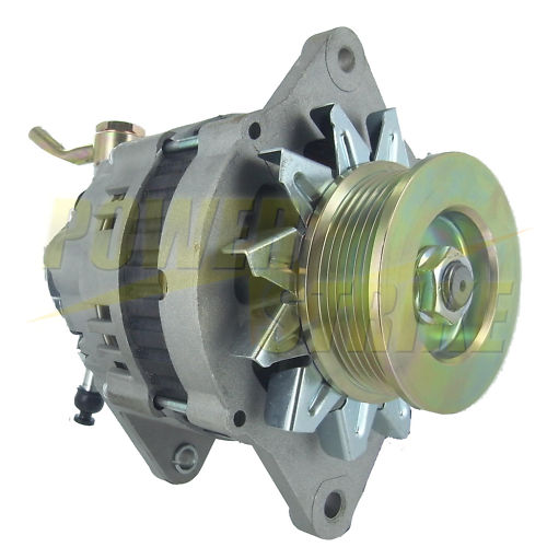

ID:	377556Lots of ford diesels have belt driven pumps on them, that should be dead easy. Some Isuzu diesels had vacuum pumps built ont he rear of the alternator also. Larry
