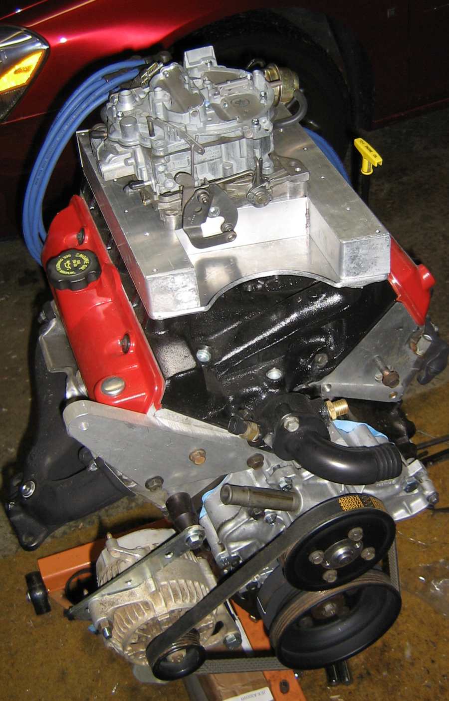

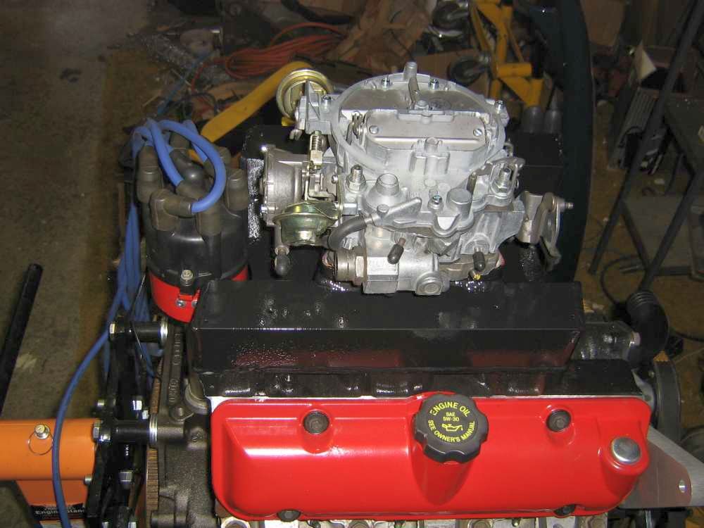

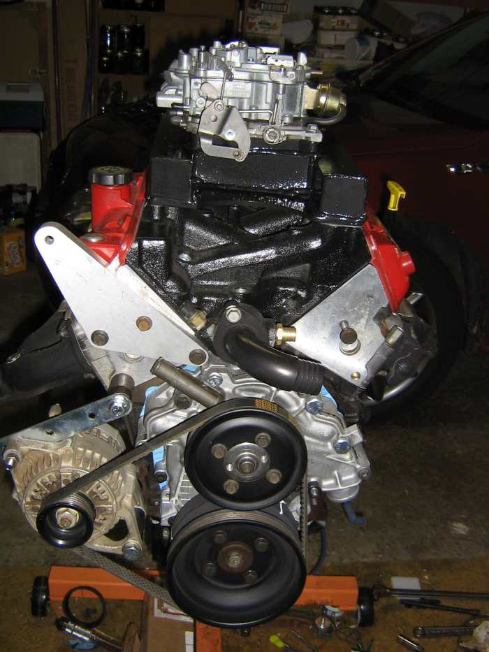

    Yes, it is a single chamber intake, just built up on a 1/4 inch thick flat plate. Larry

      i seriously cannot get over how awesome this is lol.
      any pics?
ID:	377561Click image for larger version
ID:	377558Click image for larger version
ID:	377559Click image for larger version

        • #19
          I sure hope that air filter is just for looks, I have seen them burn up on a small backfire and then the burning pieces get sucked into the carb.
          • #20
            You are 100% right, it has already melted some, I took the foam out and just use the screen to keep the big chunks out until I find sometning else. Run from these things, at least they are really cheap! Larry

                    so you are using a stock 3100 lower intake and custom made the top part to bolt a carb ??
                    awesome!! looks great.
