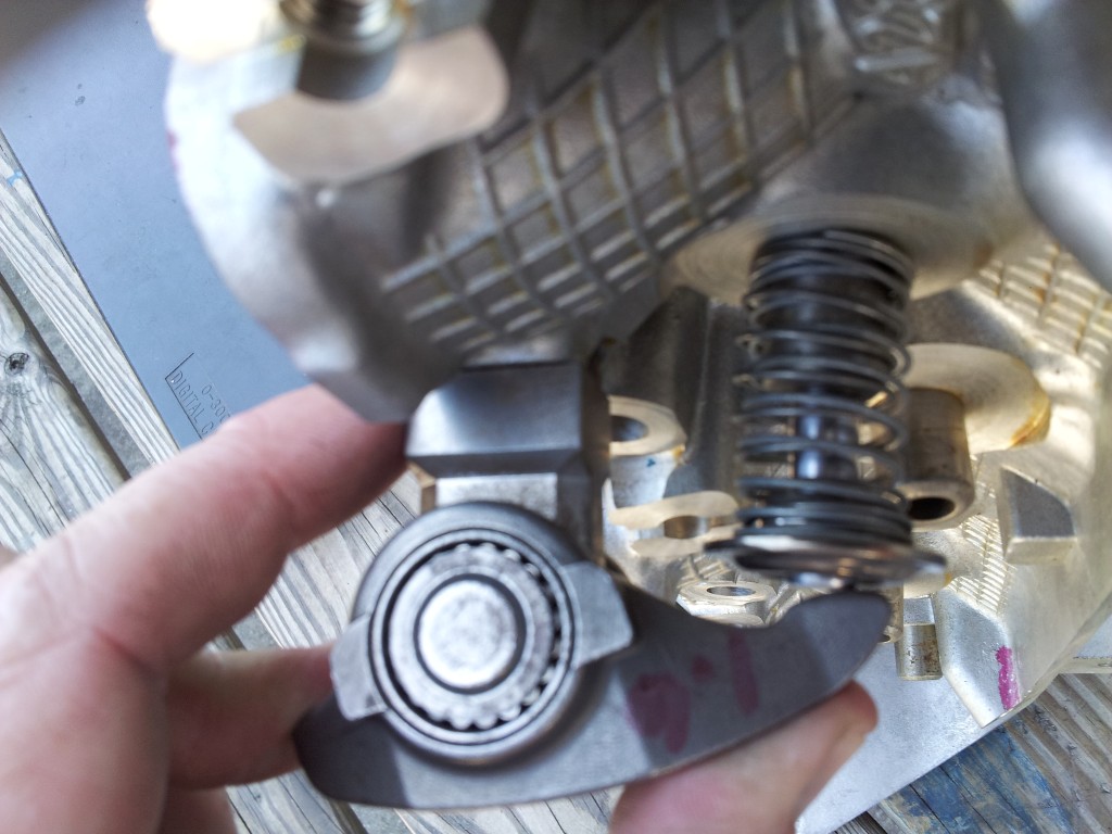

          I went out and test fitted them, looks like a go, probably need new pushrods, when I installed one on the exhaust, there was a little play. I'll post pics tonight. FWIW, I'm going to try to pick a set up and run them.
          • #20
            installed a rocker on my LX9 3500, and it bolts on no problem with the LX9 pedestal swapped on. I didn't turn the engine over to see how the work through the lift curve, when I get the new engine back from the machine shop, I'll do a more thorough check.
            a proper install will likely need new pushrods, and I would recommend valvesprings too as the 3x00 springs suck... On the exhaust valve I installed the rocker on, there was a very noticeable amount of play, over .060". this could work out to be a very cheap and easy mod for the 3x00 engines.

                    at max lift the rocker might possibly contact the pedestal, the LZ4 pedestal is machined for greater clearance where the contact might occur.

Name:	17rocker (Medium).jpg
                                Roughly .700 lift max on stock rocker. Roughly .540 max lift with 3900 rocker. Geometry on the valve tip at .540 is why we didn't move forward with making these work. Its already on that edge with very little lift. Interestingly enough, the 3400 rocker on a 3900 has the best geometry of all the combinations. Starts on the inside edge and is dead center for everything else.
