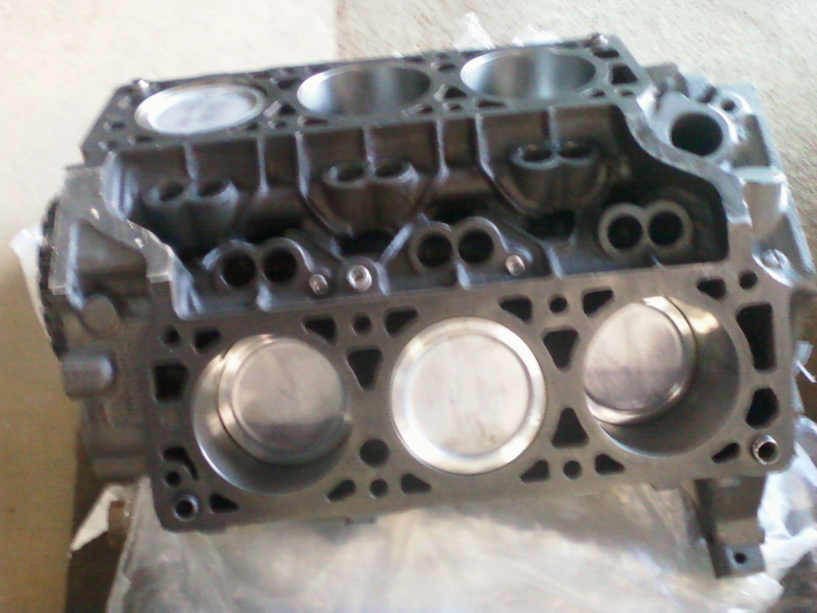

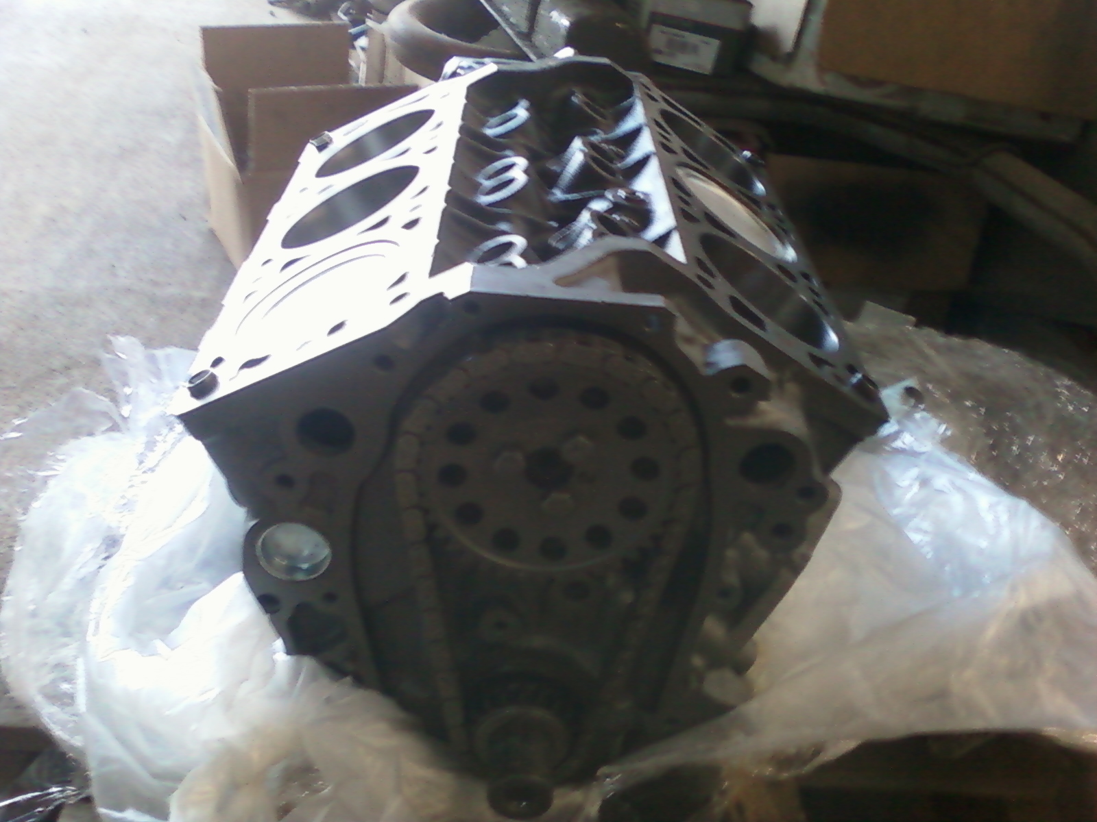

    I bought a short block awhile back that i think was bored .020 over (have not measured yet)for my 91 beretta.I finally got a set of heads ready and unwrapped the short block to find out it does not have the crank sensor hole drilled out in the block.Has any one ever drilled out a block for the sensor? Has the threaded hole beside it.Also could i use the crank shaft from my motor that has the sensor pick up notches on it? PLEASE ANY HELP!
    You'd have a hard time drilling the hole being g square and then keeping the sensor air gap . I assume that crank has no tone ring for the sensor and you wanto use your crank. You'll have to check if that is a small journal crank and if its not you can use yours and have to rebalance the rotating assymbly.
      You could probably use an external crank trigger if you can't drill the block.

          ~86 and earlier FWD blocks probably didn't have the CPS hole drilled, 87-94 would. If it's a RWD block then 82-92 would all basically be the same and not have the hole drilled. If it's a RWD block it won't work in you application. The mounting bosses are quite different. There isn't much dish to those pistons either, they look like they're for an iron head application.

            Thanks for the replys! I wanted to make sure of the obvious things before measuring crank. (didn't want to take apart yet)Like block does not have fuel pump hole and starter mount is on front side like a fwd.(Thank you for the pics.) The dish in the pistons look the same as my 3.1 out of my car.Also what do you mean the mounting bosses different? For what? Would the external crank sensor work with obd1? THANK YOU GUYS AGAIN! Guess that's why the company i got it from is out of buisness.
              Superdave is refering to the motor mount bosses. Seems like they mixed parts up on that engine. If those are aluminum head pistons then they are using a iron head engine block and assymbly. Crank trigger will work for obd1
                Ok, so you have an early FWD block then. The only way you'll know if it's a 2.8 or 3.1 is to measure the stroke or pull the pan and check the casting numbers on the crank.

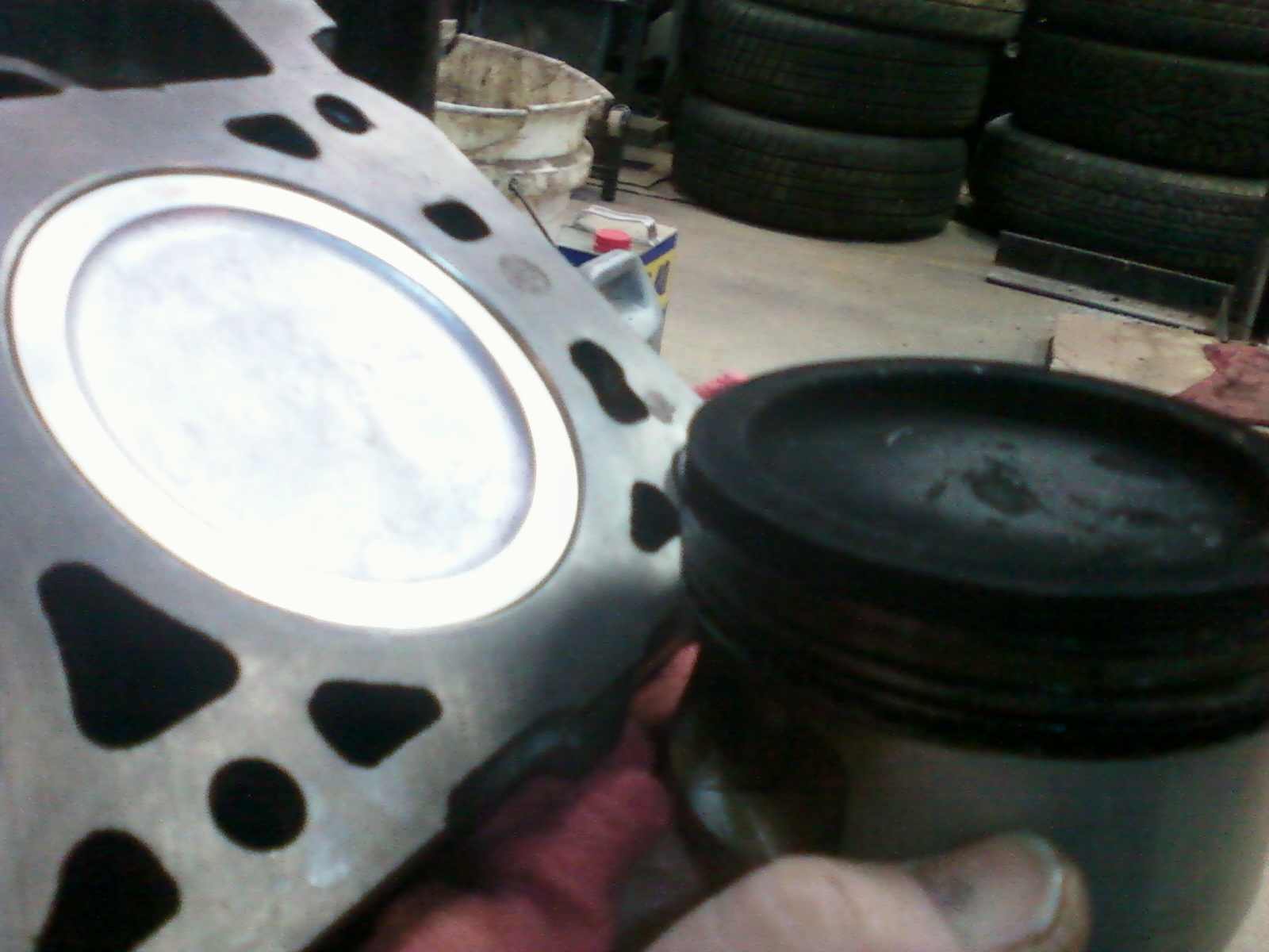

                  Thanks for pointing out about the dish in the pistons. i unwrapped short block again today and piston are not dished as deep as my 3.1 pistons. so yea i am believing this is a early fwd iron head eng. Do you know what pistons they used in the early fwd. eng. Will the aluminum head valves hit the shallow dished pistons?I will have to check the crank #'s. Would this short block work for a fiero?THANKS SUPER D. AND TURBO G.( Hey that sounds cool).I guess i got an expensive boat anchor.Anybody got a boat?

                    With the stock cam they'll clear but you are going to have some really high compression.
                    2.8 Iron heads used 0cc flat tops, 3.1's had a 12cc dish. yours look like the 12cc..

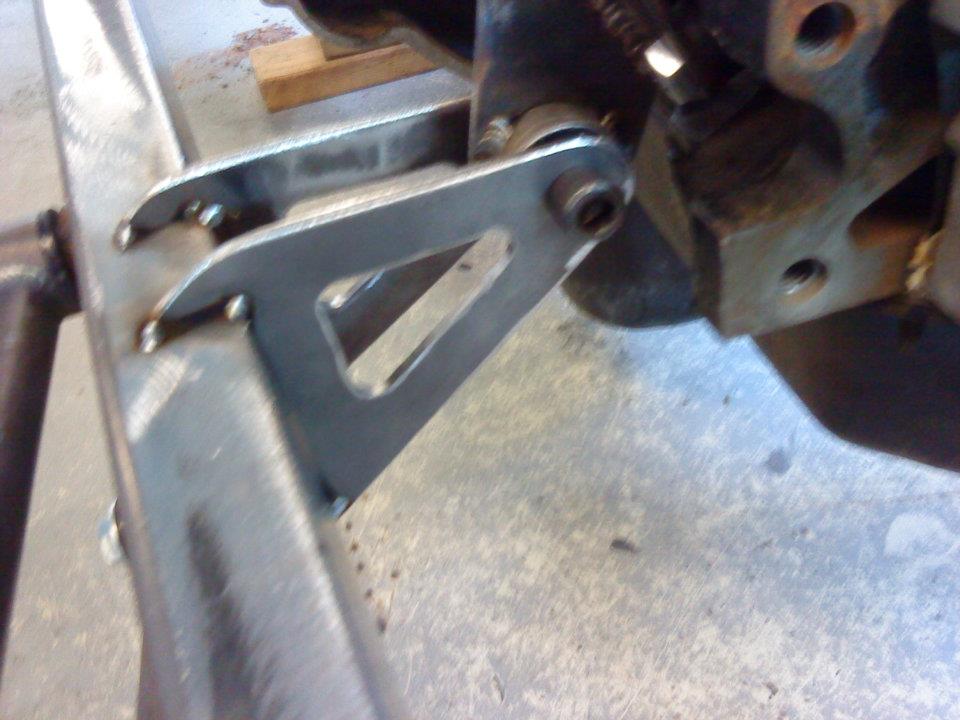

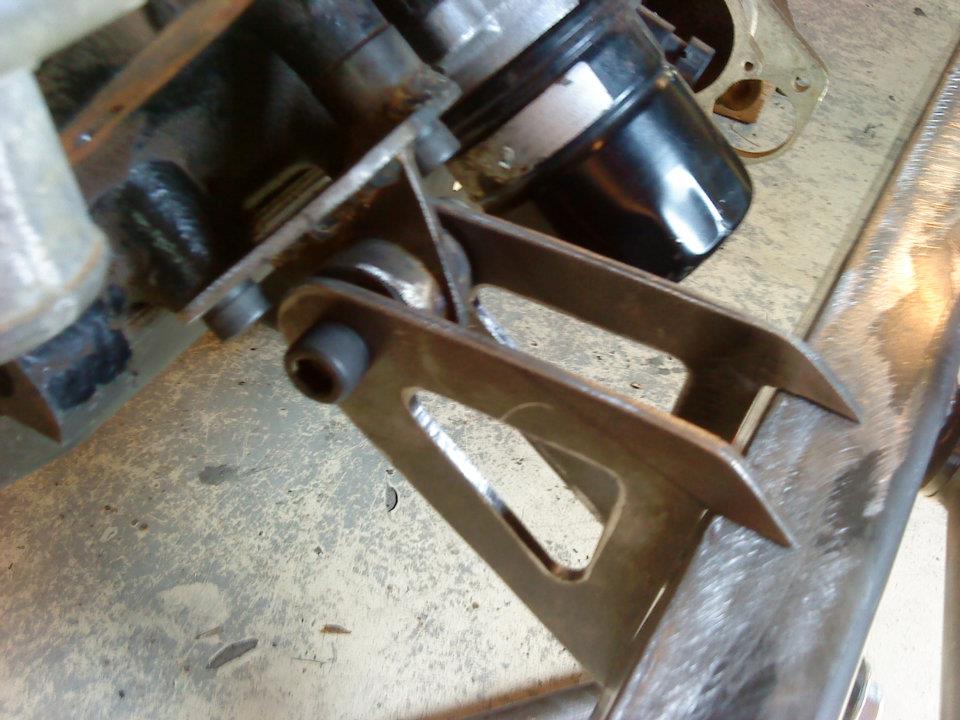

                            A couple of years ago, I bought what was supposed to be a rebuilt S-10 2.8 engine off of Craigslist, but upon closer inspection, it turned out to be a 3.1 from an Isuzu. If I had been going to use it in an S-10 or Camaro, I would have been upset as the starter location and engine mount location would have made it almost impossible to use for that application. But since I intended to put it in a street rod, and the price was "right", Click image for larger version
ID:	377393Click image for larger version
ID:	377394Click image for larger version
ID:	377395it just made it a little more difficult to fab engine mounts.

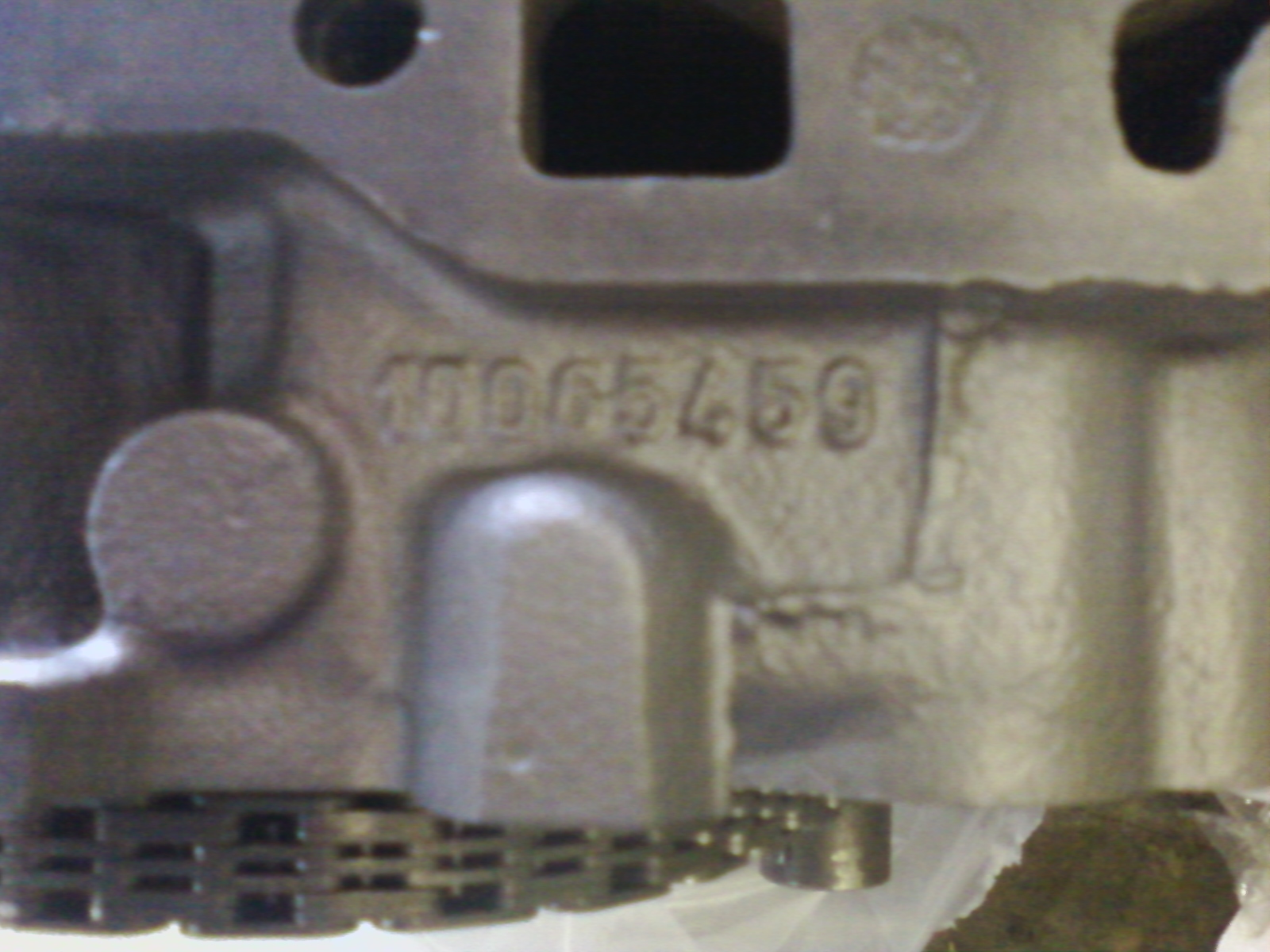

                              I did check crank #'s and they are the same. 881 or 981.3.1 Below is a better pic. of pistons. Also would it be easier to do 3400 swap with the external crank sensor or get machine shop to drill hole for cp sensor. I have a spare 3400 eng. but needs heads gone over.I did kinda want it stock looking.Also fuel economy is not a worry but power is.Click image for larger version
