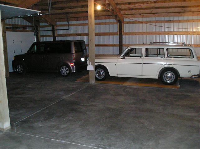

          About 2500 lbs. Yep RWD. Thinking 200R4 but 700R4 from a S10 bolts up? Might consider that.
          Its actually my wifes car, so no stick.
          Click for bigger picture. Next to a Scion its still pretty small.
