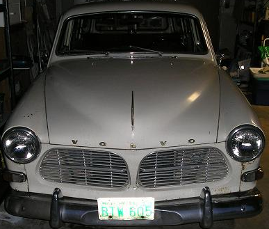

    Just thinking here before I get all worked up and try to source a 3500 for an upcoming
    vintage car swap.
    Any low points or concerns?
    Thanks in advance!

                  Noticed your links, when is the site going to be up and complete? looks like some of the MG stuff would come close to working in my Volvo.
