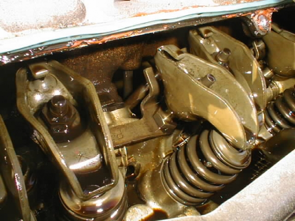

I think those are simply pushrod guides. Perhaps to help with pushrod bending/vibration at high RPM?
Though something similar might be do-able.
One thing interesting about the Gen III+ heads they have the steel mounting pads for the rockers. LS7s which use similar rockers do not have this, nor do the older style. They rely on the stud to transmit all the bending. If torqued properly the Gen III+ rocker mount pedestals help to transmit some of the bending to the base at the head.
The gen2/early 3100 guideplates would help a little but the majority of the problem is at the top of the stud.
longer studs and something like this is going to be the answer...
Now, to talk Marc into making them, and some valve covers that they'll fit under.. haha

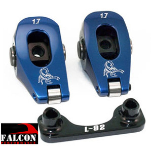

No need for any girldes, very stable, and possibly easy to make work with a stock rocker....and you can use studs that would not have to be machined down and no guide plates.....Just sayin. Or you can go the old school way that scorpion did with their LS rockers and use a pedestal with flats and have a piece of steel quite like the guide plates hold them together so they do not spin or move. No need for guideplates or extra machining and very stable. And possibly more cost effective.
This is the new pedestal they make for the LS3/L92 style heads, a slight improvement on their older design of a pedestal and a holder plate.
This is roughly what the old pedestal looked like, you can clearly see the flats on them where the U channel sits.
