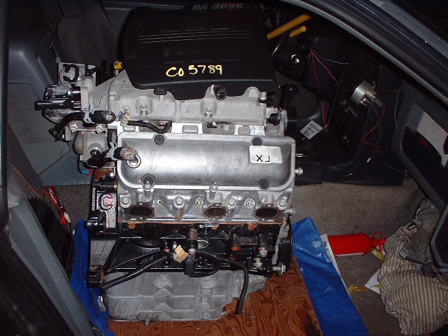

                          Perhaps I'm not familiar with the purchase price of a 3500 but I paid around $600 for the 3900 I have (around $800 shipped). And I got it with 17K miles, harness, computer, A/C Compressor, starter, alternator and all sensors etc... pretty much everything I need for a swap.
                          As I also said the LS4 (5.3L) from the FWD Chevy SS and Grand Prix seem to also be selling at an affordable $1500 complete with transmission.... Are the 3500's really that much cheaper? I guess you could probably pick one up for a few hundred bucks with higher mileage on it.
