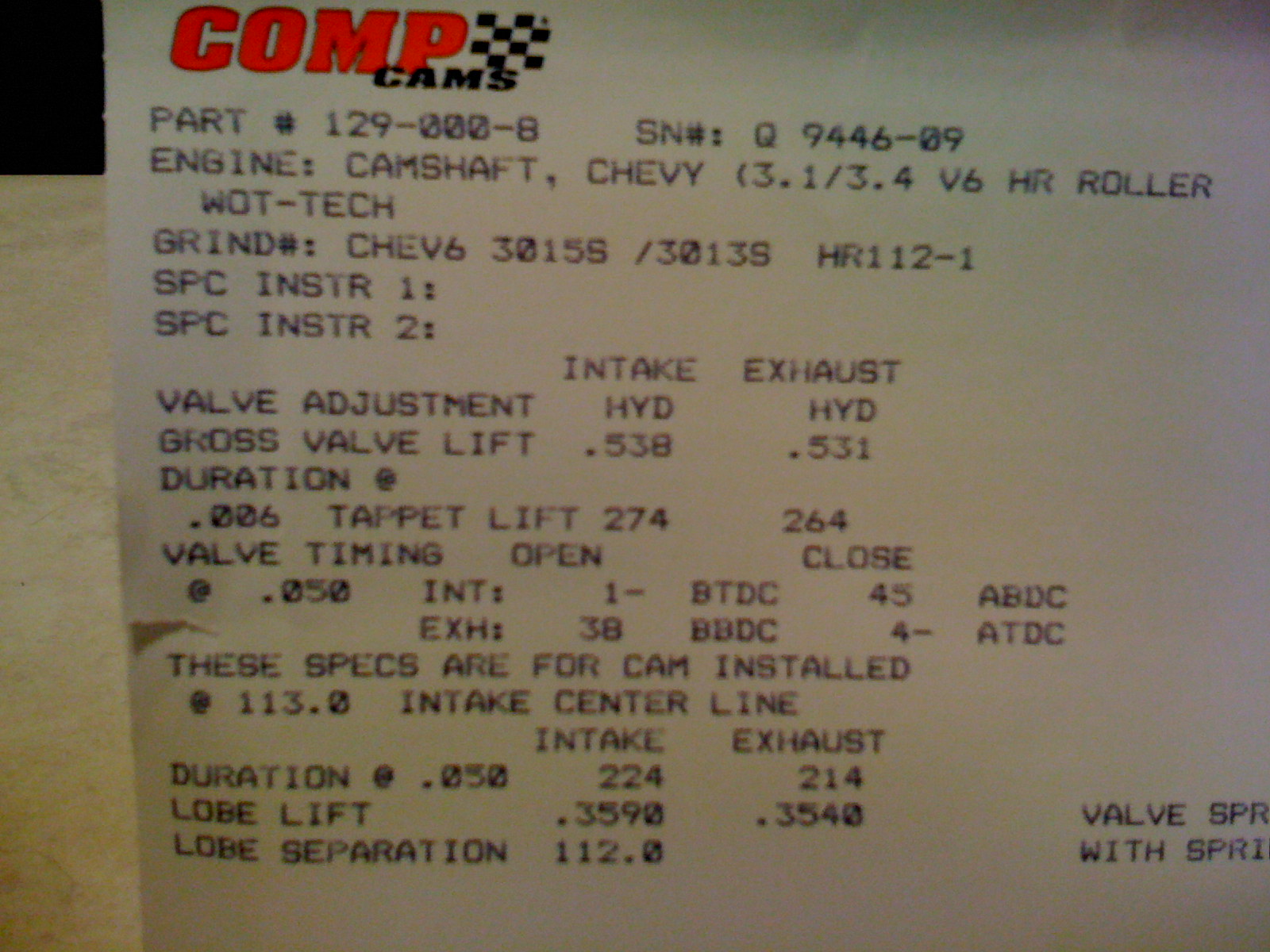

                      Northstar throttle body, long tube headers, non variable intake, comp cam with .610 lift( I'm trying to attach a photo of the cam card but haven't done it here before) AEM 4'' air filter. 4t65e-hd trans with 3.73 gears. I'm told the lower gears throws off the dyno readings but track times don't lie and they were pretty consistant. I'm not sure if I had the magnaflow muffler with the last track run. I was running dual corsa's but it was long, hot and heavy. It seems to run better with a single 3'' into magnaflow anyway. I also raised compression almost 1 point with the head gasket change but this was after the track run but it definately feels stronger despite the incomplete tune. As for why the low numbers, I have a couple guesses but am no expert. Maybe the cam is too big, along with stock compression ratio. Rear tires are big and heavy. tune needs work. Oil pressure was low until I took off the oil cooler which may have affected the lifters. I know the oil pressure wasn't high enough to use the LS spring upgrade. Again, it's fine now but I'll have to wait until next year to find out any results. I'm open to suggestions of course, 350hp would be a nice improvement.

                          The heads are stock. The headers are 1 5/8'. 32'' long but one tube came out short because I ran out of bends. The cam card is for 1.5 rockers so that needs to be adjusted. I know Sappy said it should be 310hp conservatively.

                            So I figured I would make only one change to your motor. Still using the stock flow numbers I decided to experiment with that dual pattern camshaft.
                            I think that cam is kind of odd having more intake duration than exhaust. All the dual pattern cams I have used have always been the other way around. Perhaps that cam was designed around older style heads where the intake did not have such great flow in order to help the intake side out a bit.
                            I changed the exhaust duration in your simulation from 212 to 230 creating a more traditional dual pattern cam where the exhaust is given the greater benefit. Your power jumped hugely to 321 at 5500 and that number hung on until 6000.
                            What I learn from this is that I think the 3900 heads can flow substantially more in than they can get out, so I am going to look at a different camshaft choice.
