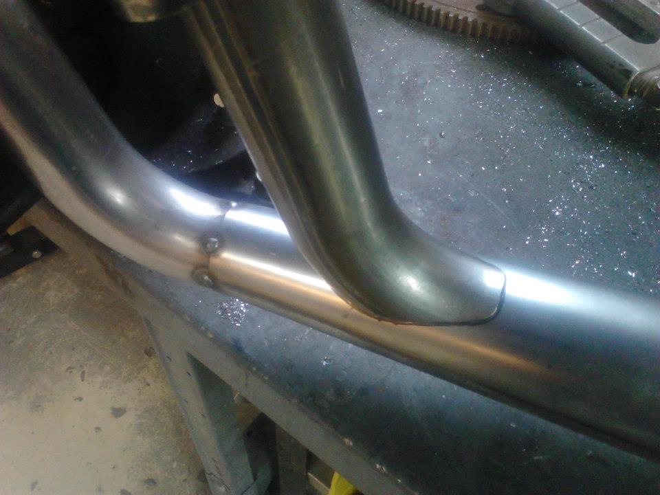

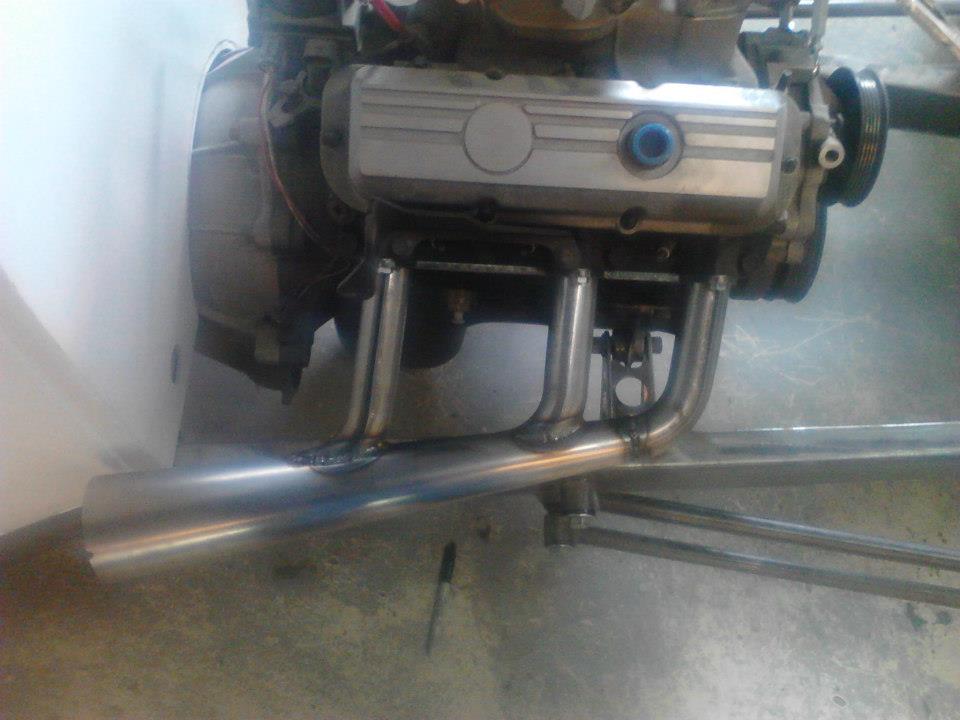

Got to work on the hotside today...
I started by cutting a U bend in half
Then I cut a side off
Then I welded the cutoff back on 180*
Then I made a window and started welding.
Rinse and repeat...
Almost done.
