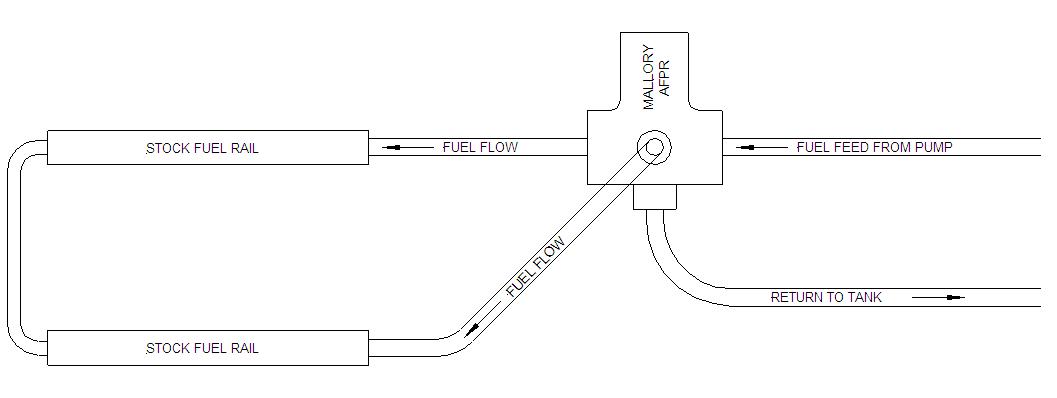

            You could just get one higher capacity pump, configure the lines like this:
              That is a beautiful build.
              Yes, a walbro high pressure/high flow with larger fuel lines would also be effective.
              I bet the fuel pumps could be controlled via voltage adjustments, just as long as the amps remain stable. Using a vacuum triggered resistor of some sort maybe. An electronic VacFPR. But that is getting a little tricky to do with a stock PCM. At that point, I think going Megasquirt would be a better option first.
                I think trying to control two pumps would really complicate things. It would be cheaper and simpler to use a single large pump, external regulator and lines feeding each side of the fuel rail. A setup like this is easy to do and works well.
                  And I must give you credit for steering me in that direction, works great so far.
                      I like the Mallory Lines graphic posted, that seems to be the most effective and simplest method for dual feeds into the fuel rail.
