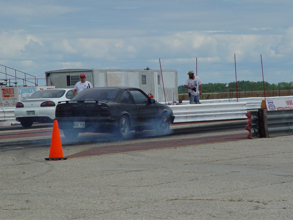

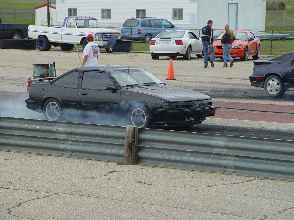

    and the best of the day:
    60foot: 2.134, 1/8th: 9.289@ 76.150, 1/4: 14.391 @ 96.479
    cant wait untill the Holley ECU and new injectors go in, still have to wire up the MSD DIS4 as well. and i'd Love to get some Drag radials or go all out and get some slicks!! :P

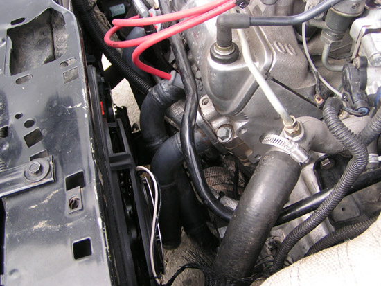

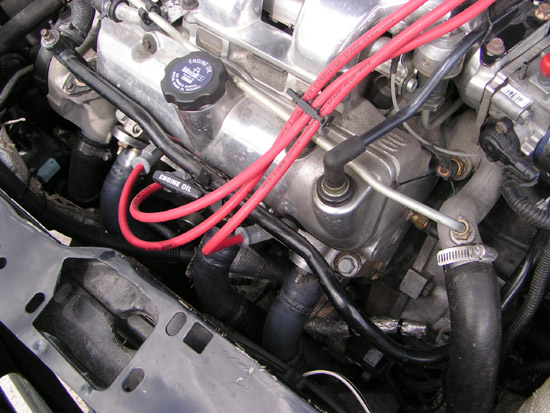

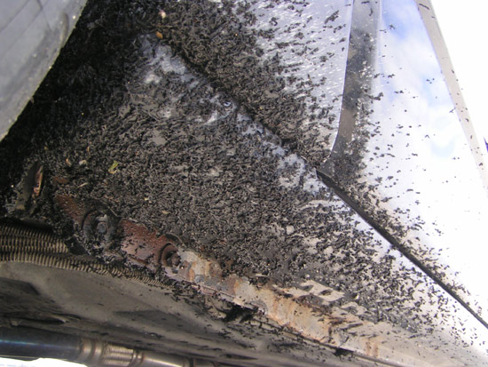

                        some pics (sorry for the size of the 3. i didnt bother resizing them)
                        (yeah for those with a keen eye the condenser has been removed and the a/c lines are still disconnected... removed it friday night to install the new cooling fans properly, didnt want to put the plastic push through ties through the condenser.. it will be reinstalled this week, i now have to convert over to R134a... had to remove my fully functioning, very cold, non leaking R12 from the system to fabricate the headers... the sacrifice's we all make for more power i guess)

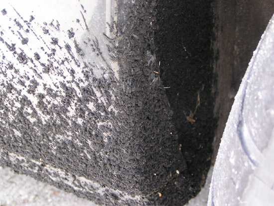

                          Car is sweet! You are ugly as hell! Go back to Yoda! You can get the rubber off your fenders with "My Ex-Wife Rubber Remover"
                            yeaaahhh way to go............ 14.3 N/a Wow man. thoes headers helped alot. I guess the better gearing did too but stilll
                            SEE look guys what a properly designed set of headers will do for you.
