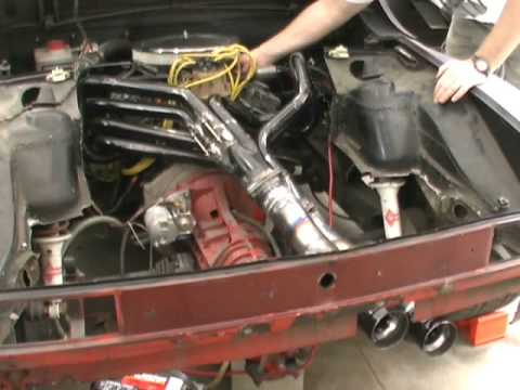

    Getting ready to experiment on a little something with a unique primary routing. Let me know what you think...

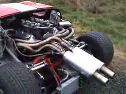

        Actually, it's an exotic car sound. Since most exotic cars use a flat plane crank and same-bank headers, you hear pairing of cylinders that are both at TDC,one on the intake stroke, one on the exhaust stroke.
        Here's an example of the same situation on a v8...
        ls7
        sbf

          so THAT'S what 180* headers mean?
          seems to work well with 8 cylinders, but on the fiero(after watching for like the 5th and 6th times), the transition from idle to heavy throttle has the "gasping" that ricers create before they start buzzing. otherwise, it does sound good.

                  Well, these headers I am talking is a 6-3-1 system, like the first video. What the intended purpose is to pair two cyls at TDC to help evacuate the opposing cylinder, thus creating the sound of three flat planes on a crank.
                  If you look into the guy's build, you will see where the primaries cross over, just don't ask me what it says...

                  Well, kinda. If you think about it, there are 3 cyls grouped together, but they are not alternating truly since one cyl in the 3-1 collector is not at the opposing position to the other 2.

                          But it IS tri-y's 6 primaries, paired to 360* of crank rotation, to one 3-1 collector. Only other way to get the same scavenging effect is to do a 6-1 collector. Search 6-1 headers and tell me what you think of them

                          OOPS! I realized when I said "first video" that the 6-3-1 video was never posted because the videographer wanted secrecy.
