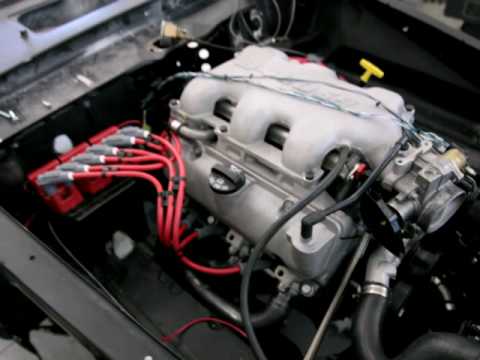

    3.4 Liter GM V6. 3X00 Top end. 11:1 Compression on Pump Gas. MegaSquirt II V3.57, MSExtra code 2.1.0. About two feet of exhaust pipe from the custom headers....
    This is a 3.4 with 11cc pistons, .040" head gaskets, 3500 heads/LIM, 3400 UIM and TB, custom headers, 60inclusive cam, chambers opened to 36cc by 60inclusive, yellow ls6 springs, Ls1 seats, stock locks/retainers, Viton seals - all in a 1969 Datsun Roadster, managed by Megasquirt.
    Very nice! I heard that getting a good idle on a MS2 was damn near impossible, but that sounds pretty good. I don't suppose you want to share that tune with me?
      People that can't tune give bad reputation to megasquirt. No idle problem here
      Nice engine, sounds good Specs of the cam ?
              I suppose I could ask the owner for a tune. We didn't do the actual swap or tune, the customer is in Cali, we are in Florida
                yes specs on cam! sounds awesome!
