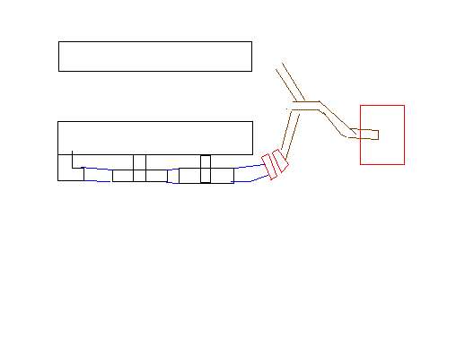

        Could you sketch that out and scan/upload your idea? What position were you thinking of mounting the turbo at? I know sometimes space can be a limiting factor, but the more equal the header length, the more efficient your tune will be.
          Equal length would be sweet, however, my space and skills prohibit this.
          That is why I am going with a log style.
          I am not finding flanges that are small enough to fit the T304 Sch 10 SS 1.5" piping. (red section)
          I guess I can make my own? 3 bolt, 2 bolt may not hold up?
          Besides being log style, does anyone foresee any issues with using this material for header, then 2" 14 gauge for crossover to Turbo.
          (Turbo will be in battery location)
          Sorry, I can NOT DRAW lol

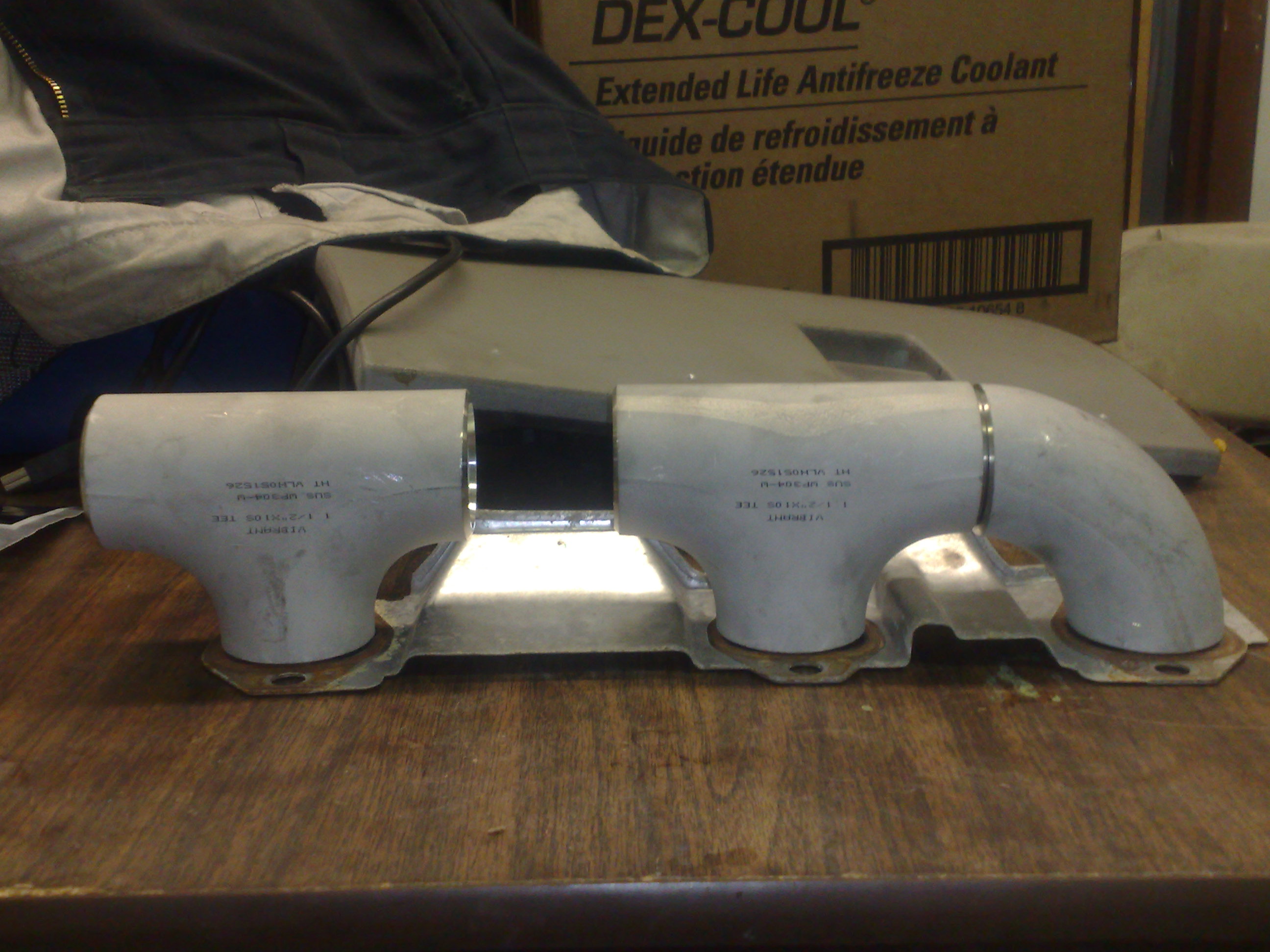

                        Ok, here is the Idea, hopefully is works out.
                        Unfortunately the straight pipe is on BackOrder grrrrrrrrrrrr looking to source elsewhere.
                        T304 stainless steel schedule 10 1.5" (1.89" OD 1.65" ID)
                        Your thoughts?

                          Pretty stiff material, and the tool to make the D shape is not big enough and the elbows keep spitting out
                          As of April 2
                          Engine: 2006 SV6 3500 LX9
                          Trans: 2002 Getrag F23 5speed
                          Injectors: #36 GTPs
                          TB: 65mm TCE
                          Maf: 1999 3400 Montana.
                          Beverages: Ice Cold CANADIAN.
                            Maybe a correctly shaped anvil, some torch time and a ball peen hammer will shape it up for you? Sometimes, you gotta get old school.....lol
                              yup, have to clean off the work bench to get the torches and metric tools out (hammers for you young guys lol)
