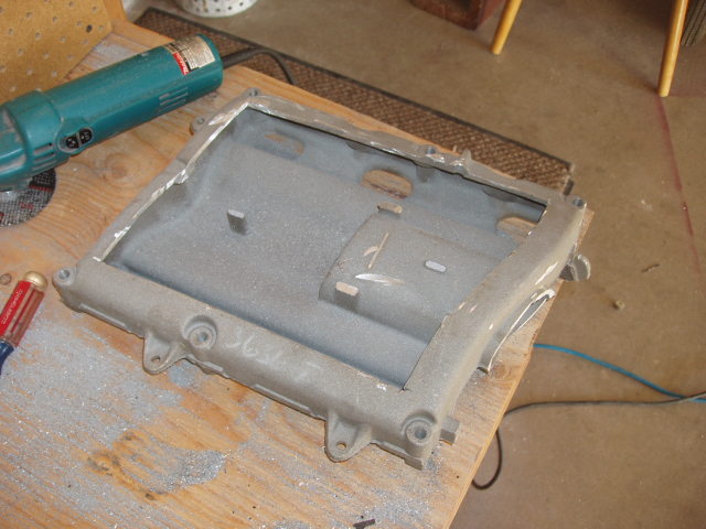

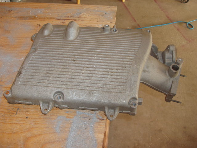

                            • Well since I decided to ditch a custon one piece and move onto a ported LIM and custom UIM..........here is where I am at with a hacked up 3500 UIM. I am now waiting for my heater core/intercooler to show up so I can have the bottom plate machined that will be welded onto this hacked up manifold.
                              • be sure to save that aluminum dust... thermite is some fun stuff.
