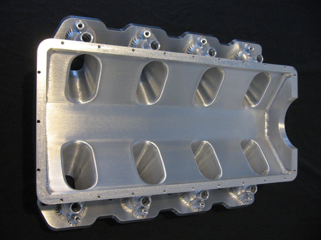

                          I have looked at a lot of intake designs and I do think the Ford SHO v-6 intake would be the ticket to a hp intake. here is a pic
                          • #88
                            Sure those runners look great, but where are you gonna fit the supercharger?
