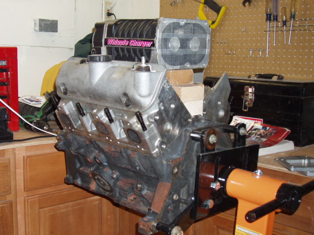

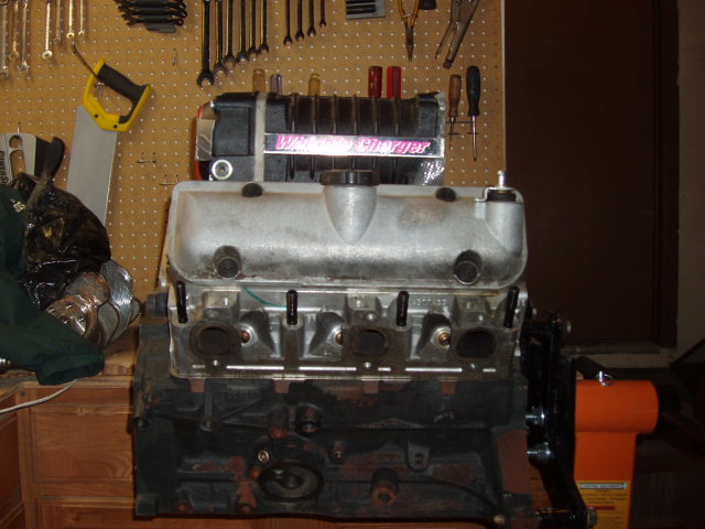

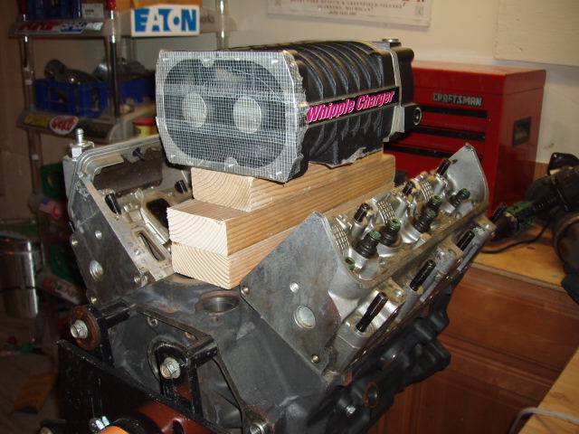

Found this today and started tinkering around in psychology class lol.........

Pretty easy to use and manipulate. I think I will use them for intake flanges and work with plate aluminum and a router after that. Probably use some material from RMR as well..
Please tell me those aren't headbolts holding your engine to the stand.. that's an accident waiting to happen.

I toyed around with the idea of a custom intake to mount a M90 from a Super Coupe. Was looking at mounting it a little lower and moving the injectors towards the valves. This would have required new valve covers to clear the injectors. The total height was going to be around 1.5" taller than a 3400 UIM.

i forgot about this concept. now that i got the intakes off my car, i wonder if i should get 3 aluminum plates and start to build a intake. i got Alllllllllllllll winter..............
EDIT: i suppous theres going to be a small problem with the snout and power steering pump...
So if relocating the power steering pump was done, this idea is very hard to play with, very little room, that this sucker is wide. theres about 1-2" to bring the blower higher, so theres not much room for runner volume. BTW the M90 was out of a burnt wreck, bought it as a mock up piece. someone would also need a shorter snout.

That thing is so big casewise compared to my whipple!! I really don't see the power steering as being a big problem. I have looked at several different options. I right now, am considering the consequences of runner length and plenum volume, since I am almost certainly stuck with a v-shaped plenum with short (1-2") runners leading into that. I can move up at least 2 inches higher than stock thanks to my cowl hood, however I am not sure if I do that if the two piece snout and pulley will clear. I suppose I could always mold a small fiberglass speed bump to the side of my cowl where the pulley would be.
