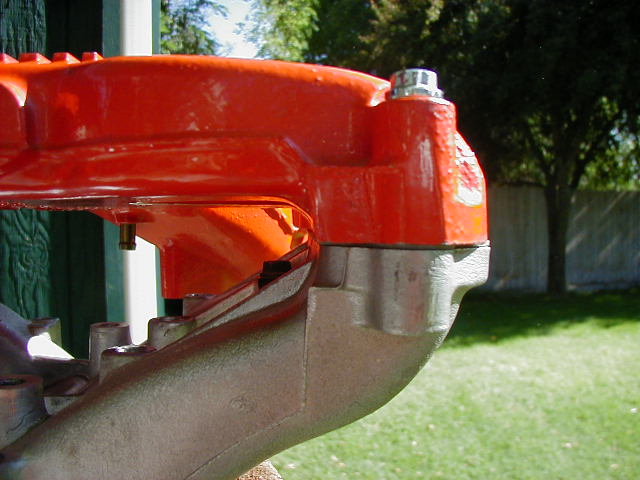

to this, I dissagee 110%, a 300* bend in an intake manifold like that is never good.
[ATTACH=CONFIG]5530[/ATTACH]
whoops you're right, I'm using new math...
the 3x00 intakes also eliminate more than half of the runner, have much more plenum, and larger ports."I am not what you so glibly call to be a civilized man. I have broken with society for reasons which I alone am able to appreciate. I am therefore not subject to it's stupid laws, and I ask you to never allude to them in my presence again."
did I mention the neck that leads to the plenum is super tiny too?"I am not what you so glibly call to be a civilized man. I have broken with society for reasons which I alone am able to appreciate. I am therefore not subject to it's stupid laws, and I ask you to never allude to them in my presence again."
