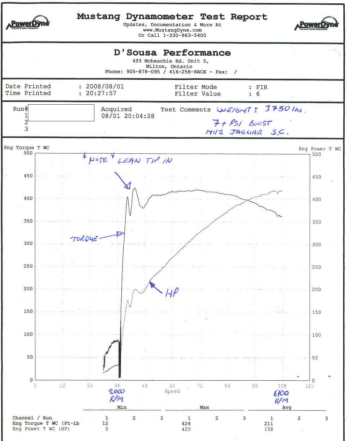

                    check this out:
                    I have currently a Saleen S4 kit on the 02GT (Got in early 03) and after several improvements I have finally decided to slap a 2.3L to get more boost...:boxing: Apart from a custom pulley (2.87"), improvements consist in intercooler sealing plate (Water jet cut) to get reliable IAT readings...
                    you would need to make it low profile like this to fit under your hood. I would also assume you would need some sort of chamber with a little bit of Volume to provide equil pressure to all cylinders... you dont want he boost to dump into a offset intake manifold and feed the back 2 cyl more air then the front 4, would cause them to lean out and cannot correct it with tune without making everything overly rich..
