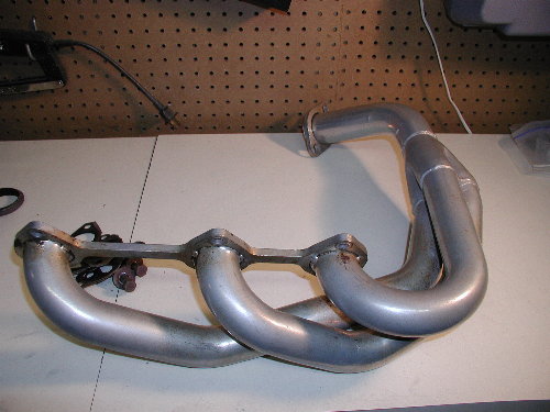

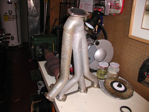

a Friend of mine wants to do headers to my car....3100 v6 sfi chevy lumina...now i know making headers is not just welding tubes...i want to know the specs of one...size of tubbing ect, ect.....any help or pics would be greatly appreciated
Custom Headers???
Search google for S&S headers, they are going out of business but that will give you an idea to start with.sigpic New 2010 project (click image)
You'll want to use 3/8" flanges for strength, WOT-TECH store sells them.
1 5/8" primaries. Ideally would be equal length, and if you can fit it, long tube. I think it was something like 32" works out ideal but it's been a while so I'm not positive.sigpic New 2010 project (click image)
Search around for posts by SuperDave, he posted up pics of his long tubes he made for the cavalier, I think in the Beretta/Corsica Header thread..
EDIT: Here http://60degreev6.com/forum/f96/proj...headers-t44375
Lots of photos there. Not sure how the firewall is in a Lumina, but the other stuff will give you an idea.Last edited by IsaacHayes; 01-01-2010, 02:30 PM.sigpic New 2010 project (click image)
