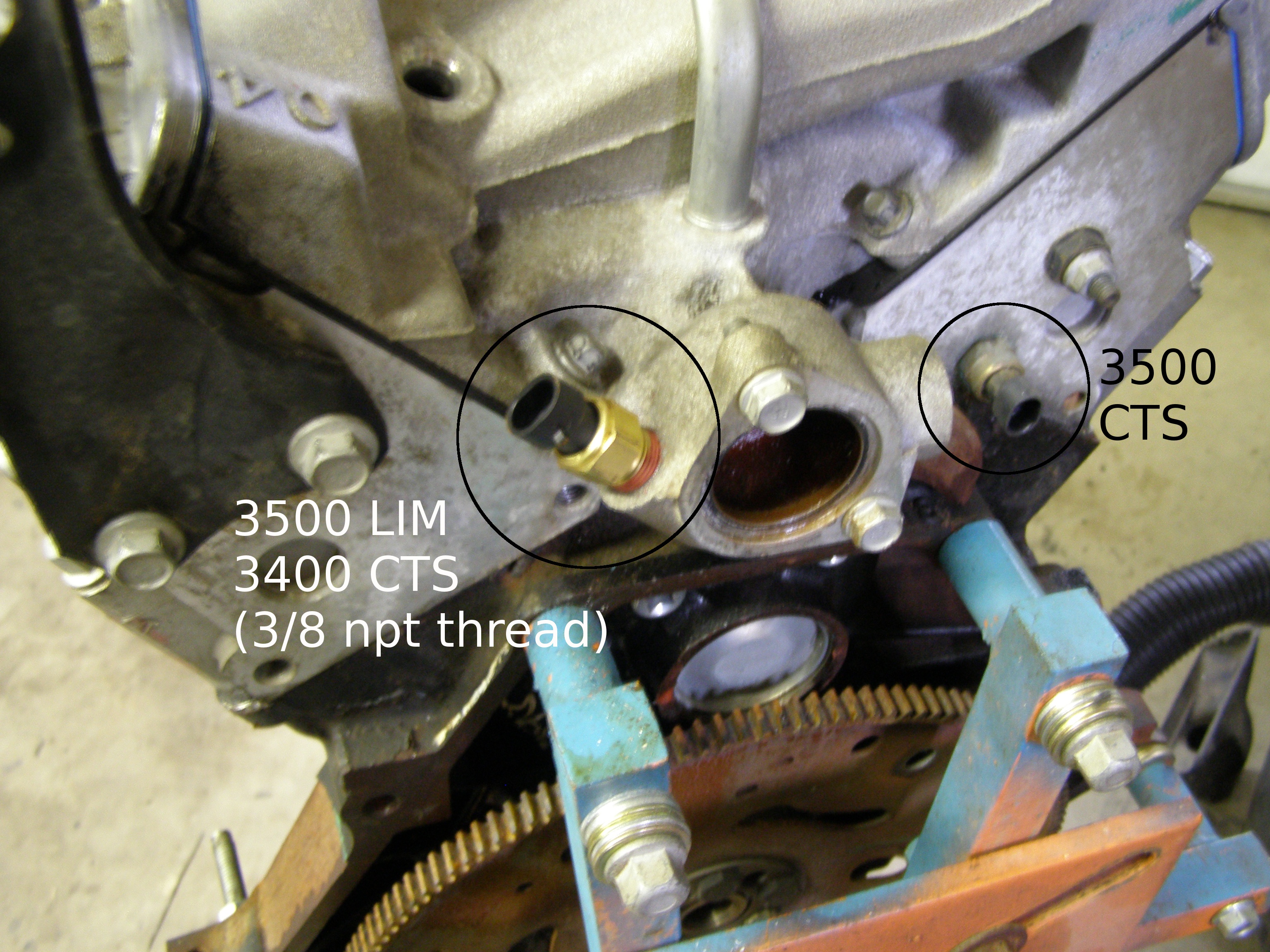

                I used a 3400 CTS and just Tapped my 3500 lim for it. Uses a 3/8 npt tap. Simple to do and wont require any modifications to the harness
