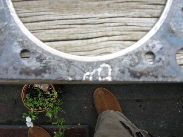

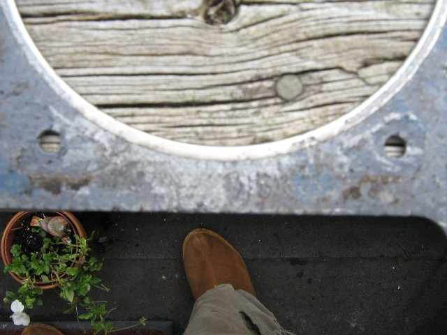

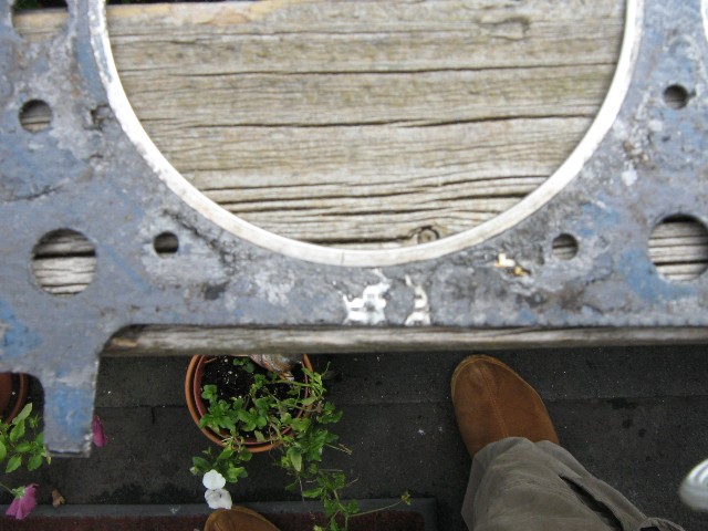

For those who havn't read my other posts.... I had coolant getting into the oil on my supercharged propane 3.4. Coolant was running out the side of head gasket into the lifter valley. I pulled the head and found pieces of the gasket missing. I looks to me like presure has blown past the fire ring and taken out the material around the coolant area of the head gasket. It has blown right through on #6 and #4 cylinders and looks to be starting on #2 as well. These are Felpro head gaskets, done in April, held down with ARP head studs.
Has anyone seen this before?
