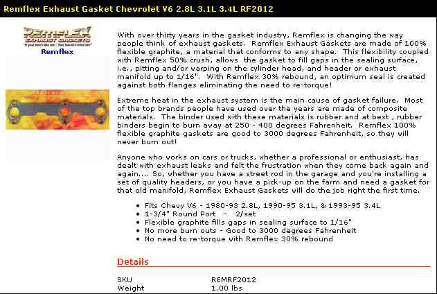

                      Have a look at these images on the "REMFLEX" gaskets...If I'm not mistaken, they have a set for the 3400/3500 series engines and if leaks and followup tightening are an issue...these babies will make all those problems disappear. The other recommendation I can make is that if you are looking for the best set of header bolts around...try the ARP Bolts being sold for the clutch pressure plate on the Honda Civic...they are super-strong, come with conical hardened washers, if you want to use them.. .and they measure exactly the proper head and metric thread size... and their depth is a perfect 25mms in length, too.

                        remflex 22bucks shipped from amazon
