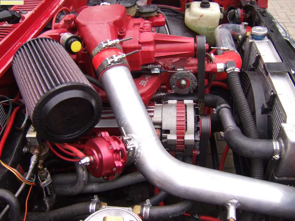

                If you are planning on using the aluminum heads, you have a lot of work ahead of you. The distributor will not clear a stock lower intake, let alone the upper plenum. So even if you used the lower with a custom upper, you are still going to run into issues mounting the dizzy.
                  berniejayd: It was made for a carbed 60*v6. I have it on an iron head 3.4. I've cut out and welded in the back cross over on the camaro lower intake manifold. It's a supercharged propane setup I made.

                    Dude I gotta see pics of that!!!
                      Did you want to see a pic of the lower intake manifold or the whole setup?
                        Anything you got. I have never seen a boosted propane setup
                          I thought I showed you these before...
                            dist...
                              No I don't remember seeing those pics. Crazy. I also noticed the Hydroboost. Did you buy a kit or build one yourself?
