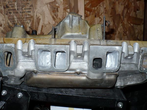

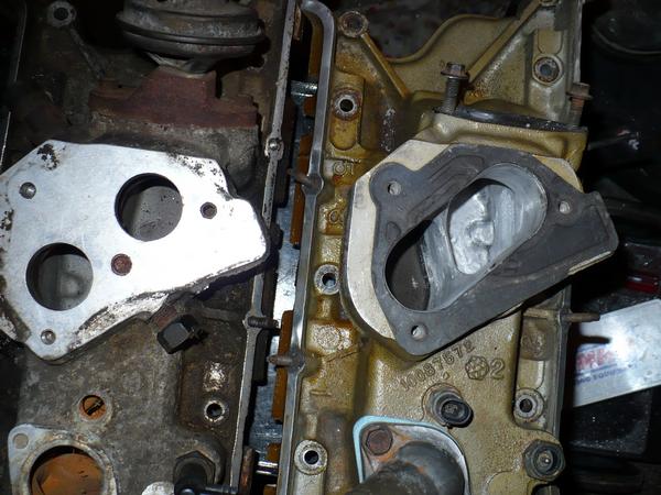

    have a 91 s10 2.8 and here is the list of shit ive done so far
    bored 30 over
    comp cam
    JE forged alm. pistons
    cold air intake
    headmen headers with true duals
    eliminated 2 or 3 pullies total
    and what im doing now
    5.7 t.b. swap
    roller rockers
    porting the intake manafold
    machining the heads to match the intake runners (port n polish)
    this is all that i can think of if there is any thing else i might be able to do let me know i would like to have the highest h.p. 2.8!! naturaly asperated of corse
    I WANT TO KNOW WHAT U GUYS THINK H.P. IS GOING TO BE IM GONNA HAVE IT DYNOED AT MY LOCAL CAR SHOW ON MAY 23RD
    Need more info than just a Comp Cam... specs?
    I'd guess you are adding maybe 20hp... Given a stock 2.8 makes ~130hp at the crank, I'll be kind and say you're probably at ~155hp at the crank. After driveline loss (~15%), I'd say you are looking at around ~130hp to the wheels.

        Yea thats the standard Comp cam of choice. What is your compression ratio with those pistons?
          yep, i'd say 110-130 WHP range...
            how much P&P work is going into those heads? how are you tuning it?

              what do u mean how much port n polish and the tune is uncertian as of right now since it is not complete do u have any suggestions
                things to add to the list hypertech chip which says it 23 hp increase, ultimate tbi mod (port n plolish pretty much) thats all ive found so far

                  Hahhahahahahah....in their dreams - or did you mean to type 2-3 BHP instead of 23..?
                  The stock throttle body shows no restriction on a 2.8, so you won't gain anything there. The head and intake mods are worthwhile, but won't eliminate some serous bottlenecks in the upper intake.
                  Best bet would have been to convert using a 3.1 crank and pistons - a very useful bump in torque, but I guess you are past that point now.

                    i beg to differ. the larger 4.3 tb significantly bolstered the powerband, especially the low end throttle response. port n polishing the heads WILL greatly improve the powerband if done correctly. at the very least get a bowl blend, that alone increases flow roughly 30 cfm on the intake/exhaust. if you have a few bucks to burn, the heads to the machine shop and tell them what you want. it take roughly 3 hours for a bowl blend @ whatever their shop rate is.
                    '86 Grand National
                      And if you reread what I wrote you'll find that is also what I said.
                        yeah i know, solows ask what it was and i told him in a nutshell. i only disagreed with you about the 2.8 tb
