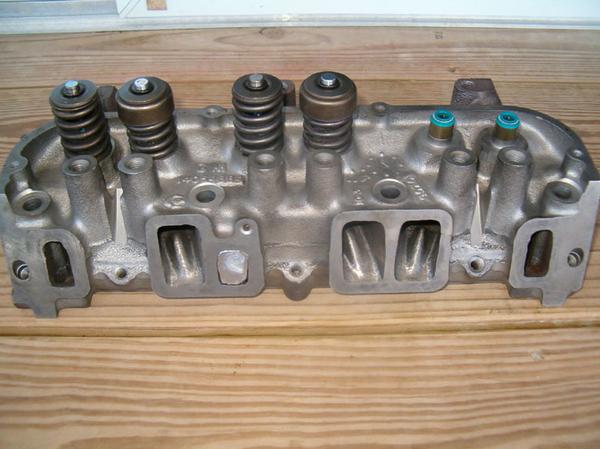

    Sure would like to hear from anyone that has done a port /polish on the cast iron heads? There is a "bump" in the front of the intake ports. From what I have read, your not supposed to mess with this too much. Has any one ever removed it and seen what happens to the engine performance? Do the aluminum heads have this same bump? Are there any good links from someone that has actually done a port/polish on the iron heads?

    Thats the sharkfin. From what I understand in theory if you plan on running boost of some sort it could be removed with no ill effects. Otherwise leave it in there as it helps out in the lower or mid range RPMs.

      like neo said, for the iron heads, leave the fin for N/A and cut it out for boost.

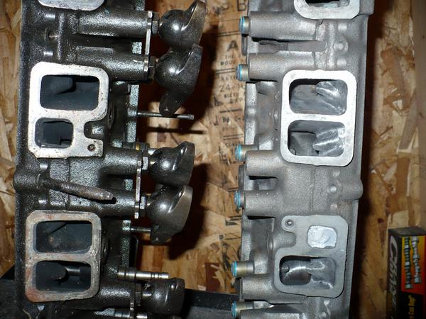

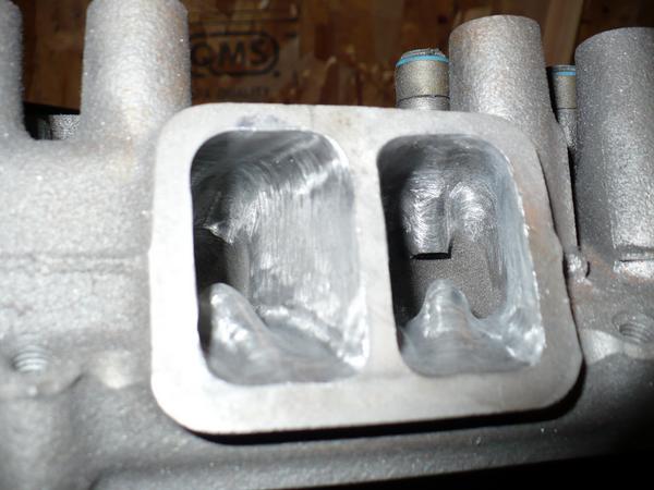

        ive done a full port & polish on the irons and i left the hump in there, just trimmed down a little. with N/A the port flows 10% more than without it. the downside is the port volume is significantly less and the port will stall faster. the bowls are terrible and need some tlc, the short side radius needs lots of work as well

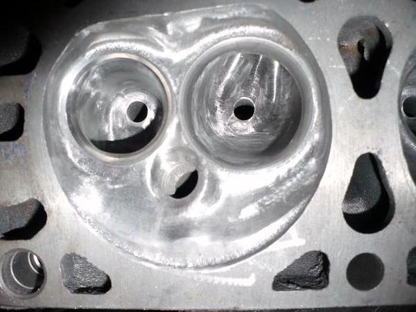

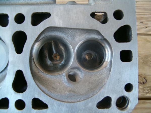

            removing the fin will cause the port to lose some velocity, thats why the engineers developed that, to keep velocity. and the fact that the ports sit low has an adverse effect. when i just took a carbide to blend the bowls and remove the casting rough, the port gained 40 cfm. so the intake flowed ~135 at .480" lift before and ~170 at .480. after that i studied the ports and did some serious grinding and sanding. the throat around the valve seats really needs some serious blending; if you port match, be careful with how you blend in where the port wall bends around the head bolt boss. if you are really serious about doing work to these, study the ports before you do any grinding.
            the Aluminum heads dont have the fin

                        Thanks again 34blazer. This is a lot of help. Another question. I've done a lot of studying on head porting/polishing, but this is my first. I noticed you removed the flat area completely from the valve guide. I was told to leave a little of it flat, but from a flow stand point I like what you did. Just curious, if you read or from experience know if its OK to take the valve guide down that much.

                          you can take it down to where i have mine or you can leave a little meat on there. those bowls are really small in terms of volume. and the port walls are really wavy. theres more than enough of the guide that can support the valve stem. i made sure of that before i started grinding away. i also asked Jim at Weber racing to make sure. Weber racing reworks the buick GN 3.8 heads to rival those of Champion irons. these heads were my first P&P job , but with enough reasearch on the techniques it helped out alot.
