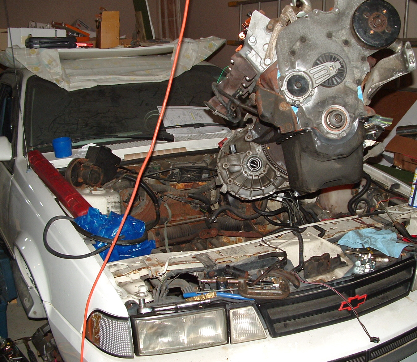

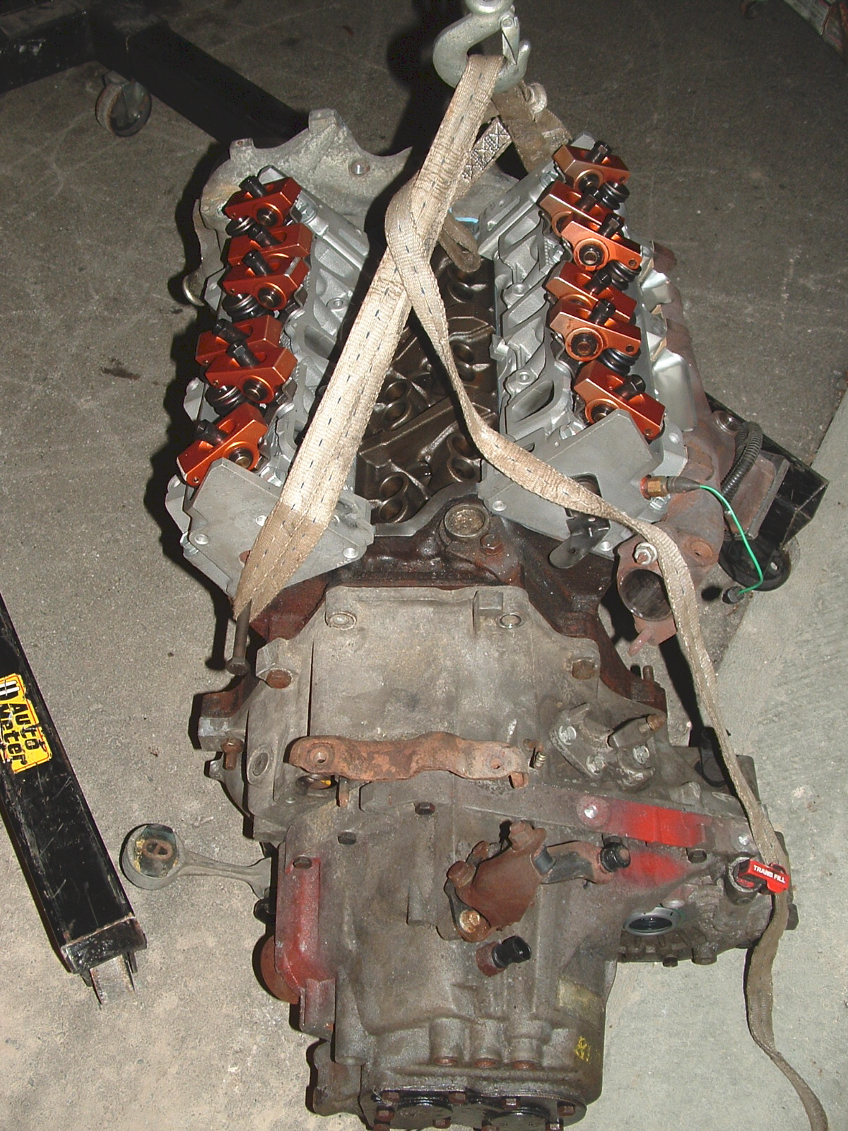

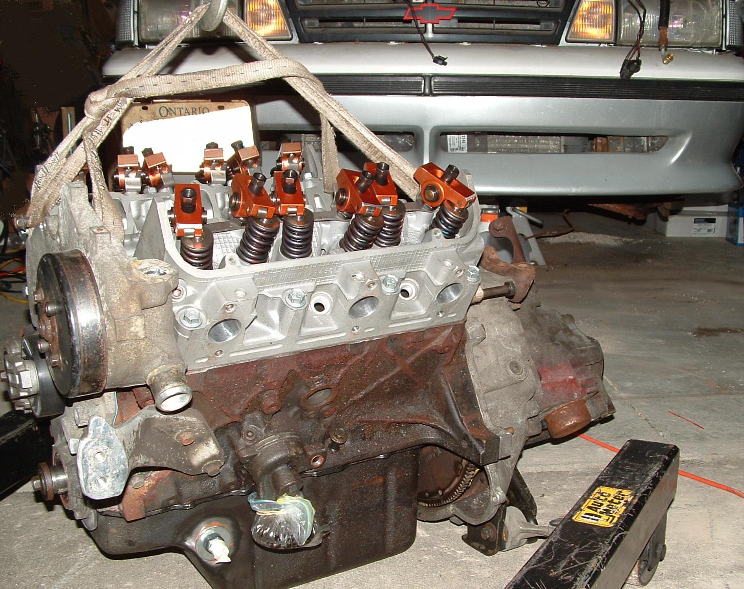

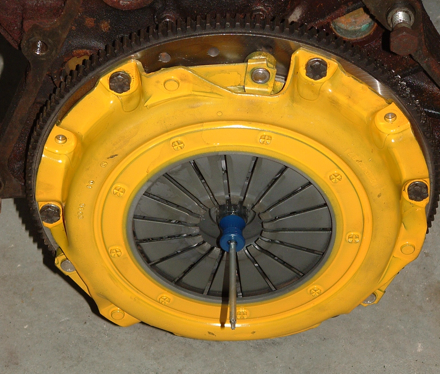

              Here's a few pics. Note the "alignment tool" I had to use in a pinch.
              And yes, the block looks like crap on the outside.

                That firewall of yours looks scary.

                    Looking good so far. Loving the alignment tool hah.
                    One question though, how did you get a Cloyers double Roller to fit on that engine? I remember something about them making that for the RWD 2.8, so did you get that one and modify the timing cover. If so, what was the machining cost for something like that? I assume they would just have to mill off a certain thickness.

                      Yeah, 15 Canadian winters in Ontario will do that to the firewall. They love salt around here when things get icey. It hasn't been winter driven since 2003, but the damage is already done. I should likely do something to it. Maybe someday.

                      The Cloyes will barely fit under the cover, but yeah, it's gotta be machined. I did it myself with a grinder honestly, so not sure how much was taken off. I used a straight edge along the chain and measured everywhere the cover seals to check things. Just slowly worked away at it until it fit without rubbing. The cover is thin now, and it is one area that I worry about for longevity. But I'll deal with it when I need to.

                        Was it only the cover that has a problem? That shouldn't be too bad as long as its not too thin. It doesn't need to be thick though...just keep the oil in and dirt out.
                          Exactly what I was thinking.
