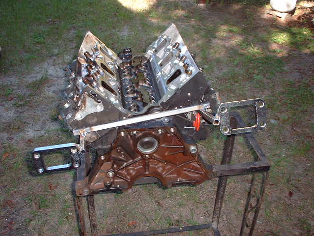

                            There are no freezeplugs on my 3900 heads, nor is there any proof that there are left and right heads. There is proof that there are not, and I am looking at them.
                            • #59
                              In all likelyhood your heads are different than mine. There is a cap at the back end of both of my heads that I call a freeze plug because it's made of metal and that's what it looks like.
                              If you swap the heads around leaving everything else the same and bolt everything back in place, water will poor out the back of the cylinderhead and there will be no return coolant flow from the front and that's why I address them as left and right.
                              Some others address them as front and rear all because of a technicallity that prevents them from being bolted on either side of the engine without making a modification, that being removing the freeze plug, coolant outlet cap "thingy" (whatever you want to call it) from one end of the head and placing it at the other if you want to move the head from one bank to the other and have the system function normally.
                              You may not think much of it, but I like to know details like this. As for the deck surface, I should have taken pictures when I thought to do so upon seeing the unusual pattern, understand I'm referencing from one end of the cylinder head to the other end of the cylinder head on the same cylinder head, in other words folding the surface in half does not produce a mirror image.
                              I'm talking about the plugged holes in the back of the heads posted in the pictures for others who may be wondering.
                              • #60
                                those are on an assembled engine. they will look like that, but you have to use the plugs so that everything works right
                                and as long as the ports on either the block deck or the cyl head deck are large enough...shape doesnt matter
