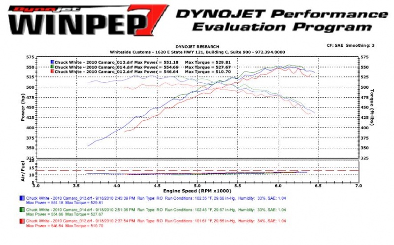

          • There is very little to be gained from the VVT that Gm uses. I have tried to tune them. Most of the people see gains just from the TM delete and normal spark advance and AFR correction and fuel trim correction. You want to see what a maggie L99 dyno graph looks like? Click image for larger version

            Tell me if anything looks funny. Now guess what happened to that car? That one even has a custom grind VVT camshaft in it.

              There is very little to be gained from the VVT that Gm uses. I have tried to tune them. Most of the people see gains just from the TM delete and normal spark advance and AFR correction and fuel trim correction. You want to see what a maggie L99 dyno graph looks like? [ATTACH=CONFIG]6809[/ATTACH]

              • That was a TSP cam and they worked with them on the cam tuning and dyno like they do to all of them. Maybe you are not listening, I have first hand results of all of this as i was there and am working in the LS industry every day. Not a false statement at all. How is it a false statement that they do not work as well as a normal cam? They have LS3 cams out now that make 500 RWHP. You cannot do that with a vvt cam. Sorry. I will try and find a dyno graph, but I guess you just dont get it. GMs VVT system is flawed and the tuners are not using it like it could be, but even if they did, it would still make no difference. The standard cam will make more power. I have about 3 dynos to prove that, but I guess proof isnt good enough?
