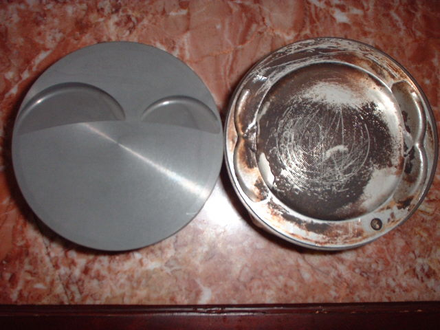

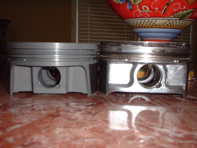

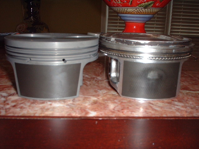

Got a great deal on a set of MAHLE pistons $381 for a set complete with rings:

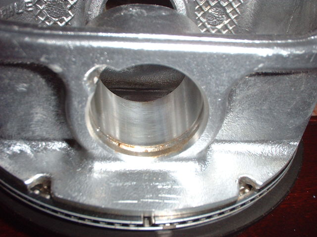

There are friction marks in the upper part of the pin bore of the stock low mileage piston to indicate that the oiling hole on the new piston will be very beneficial. Side by side it really doesn't seem like one piston is weaker than the other considering design. It is interesting that the rings are thicker for the forged piston although they are the same diameter and similar in application except for stroke of the engine
Specs:
Bore 3.898" same as stock.
Compression Height, 1.314", stock 1.305
Dish, 9 cc, stock 18 cc.
Pin, .927, stock .942.
Weigth 402 g, stock 420 g.
