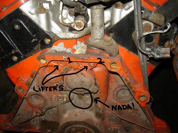

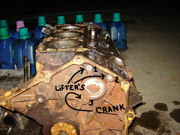

                  The old 2.8's fwd's and rwd's only had 2 oil ports, in the lifter galley's.
                  I smoked one engine in an s10, and one in a fiero due to this...
                  The newer fwd engines have 3, one that just feeds the crank "priority main" oiling.
                  I thought the newer rwd 3.4 had the 3 port oiling to it too .....
                  I have to show you what I am talking about though, you know me .... lmao

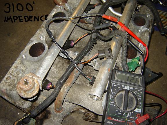

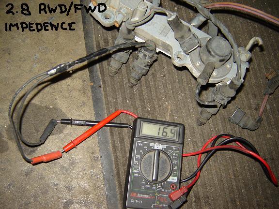

                  Heres the old 2.8 block and a new 3100 block, plus 3100 injector ohm and 2.8 injector ohm rating...
                  Here ya go guy's, straight from the garage floor.....
                  !!!!! BOSCH PLUGS RULE !!!!!
                  http://www.cardomain.com/id/powerdoctor
                    weird, i have a ton of 2.8 and 3.1 injectors and they're all 12 ohm.. either way, the higher ones should be fine as well, it's the way low ones that'll burn out the injector drivers.
                      You are right, the very low one's will scortch the driver, I have had the wires catch on fire under the dash before...lmao.
                      But on the flip side, if the impedence is too high the injector won't lift right and the flow will suck....
