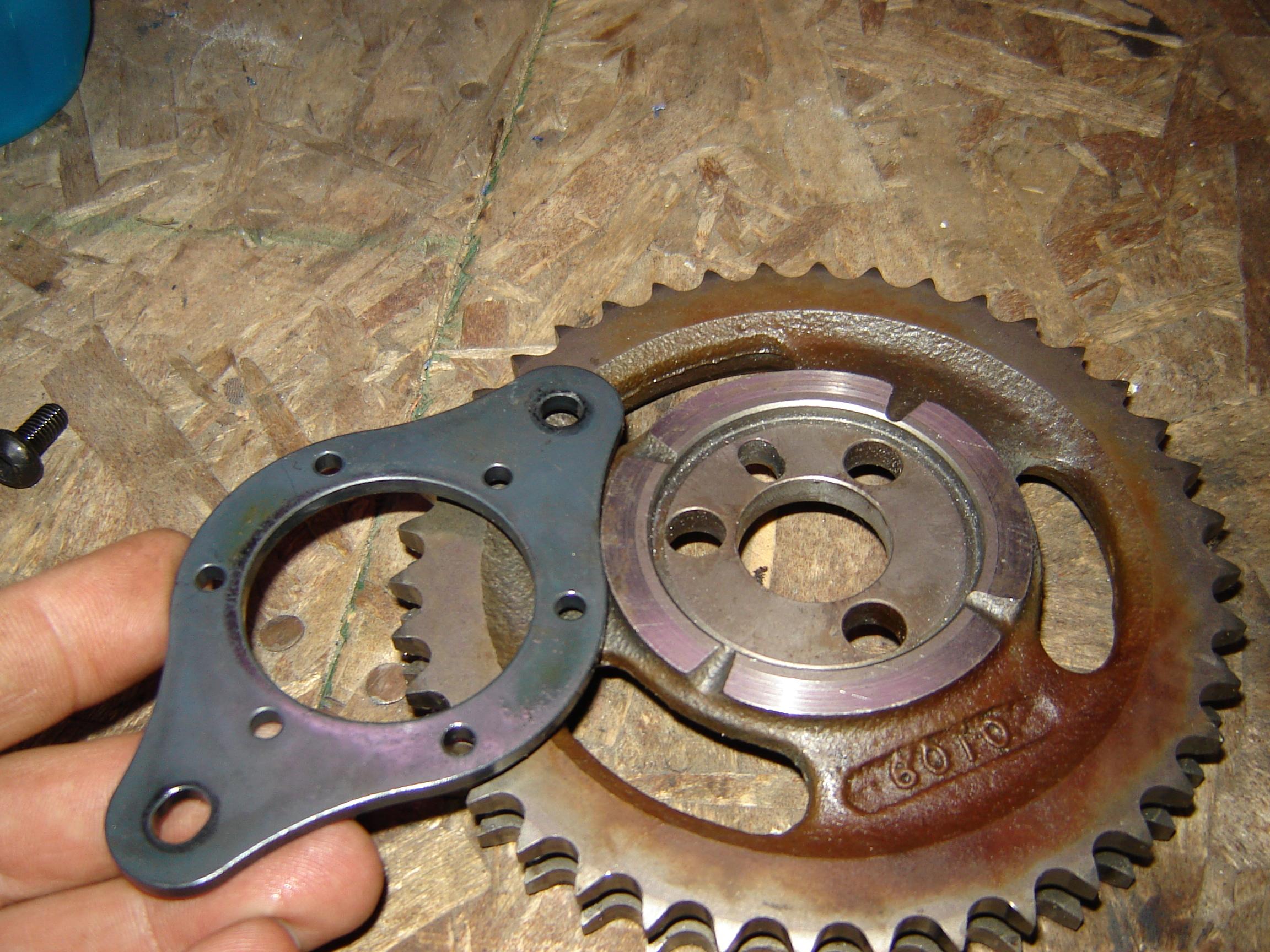

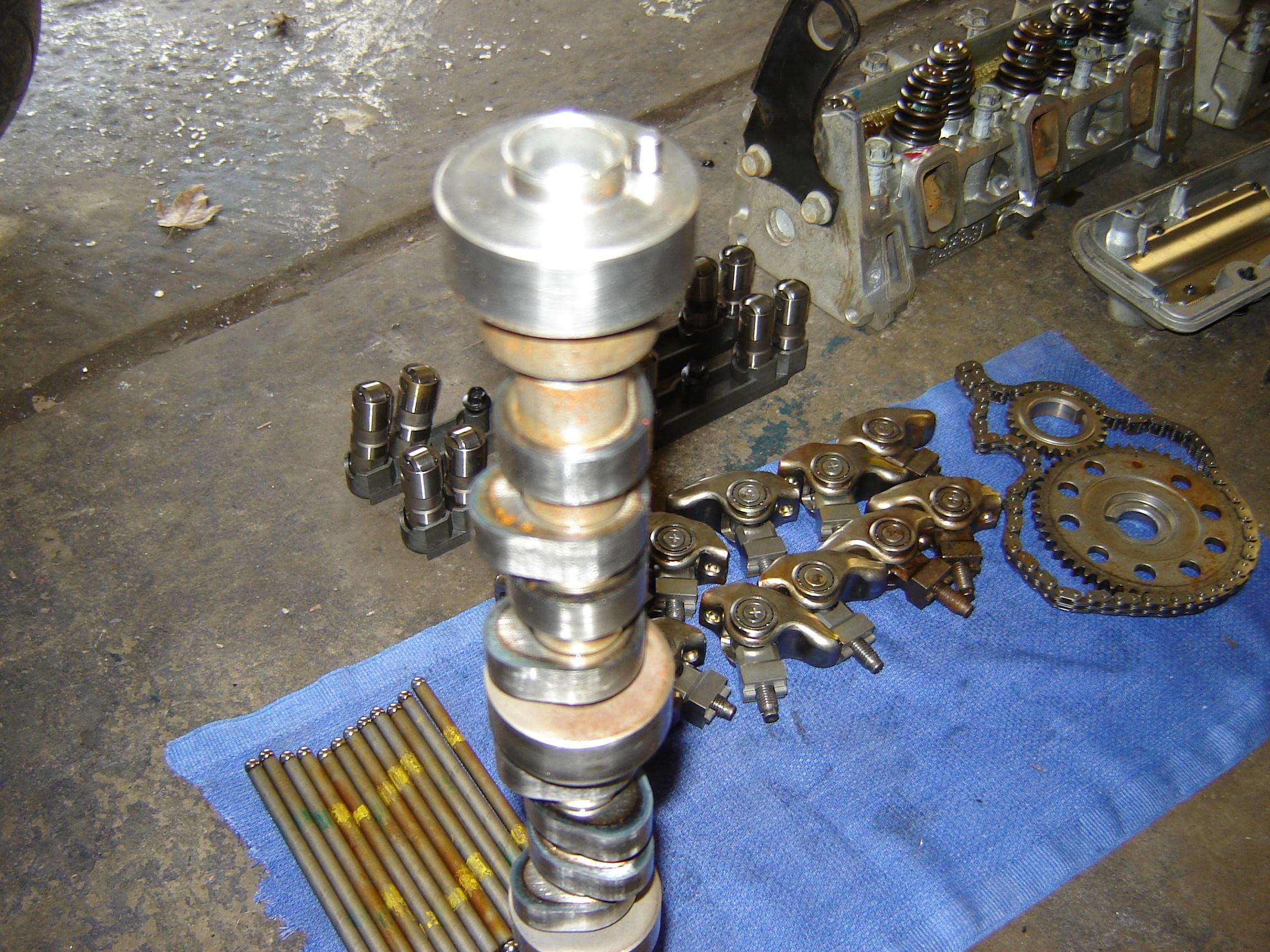

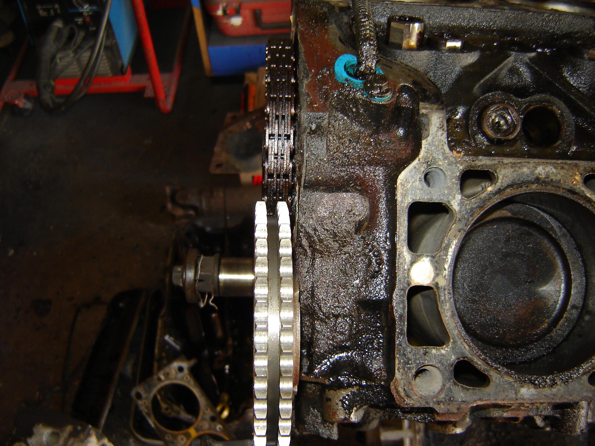

    I'm going to show you how it was done.
    I am including pictures...
    I dug out an old roller chain cam sproket and took apart an old 3.1 to show you guys.
    Pic 1, the roller chain gear.
    Pic 2, the roller cam, 00' 3.1
    Pic 3, roller sproket on cam, with hole reamed out.
    Pic 4, what you need to "take off" ( the thrust surface on the roller chain sprocket ) for the roller chain sproket to work.
    It also requires different bolts for the thrust plate to clear the sproket, or grind down the stock ones.
    You can weld the old holes in the sproket shut if you want.
    This is all to retain the stock roller cam thrust plate or walk eliminator, and add a roller chain as well.
    While I have NOT tried it under a modular cover, it clears the RWD cover just fine.

    here's another shot of a 3.1 roller still assembled with the roller sprocket sitting next to it.
    It looks to me that it would clear the modluar cover after the surface was taken off...

                After cutting the back of the gear flat, what did you use to space it back out to clear the retainer? Did you also cut the lower gear to move it back to maintain chain alignment? If so, did you make a spacer to move the dampener back out to maintain belt alignment?
                You make it sound so easy but there is more to it than what you have described. It would be more helpful to others if you waited until it was a proven method, then post each step of the modification with pictures.
                I hate to see people rush out and waste money without knowing what's involved, if it will work or destroying parts when the pin shears off.
                Perhaps your name should be PowerIntern since you are just learning about these engines.

                      I am sorry and will state that it is experimental and has not been proven.
                      If some ones wishes to try this as I have, this is how I did it.
                      And no spacing of the crank or balancer was required.
                      Once the back of the sproket was taken down and the holes opened up, it lined up fine.

                            If you didn't use a spacer or turn a step on the rear of the sprocket, what is keeping the retainer from being compressed between the cam and the sprocket? If you turned a step on the back side, then the sprockets are out of alignment. Not trying to beat a dead horse but I'd hate to see your fresh engine get trashed.
