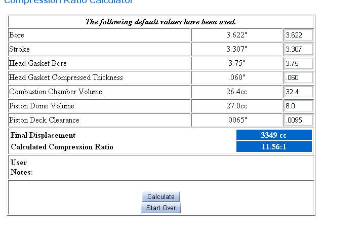

                      How can I acheive a higher than 10:1 ratio on my 3400 with 3500 upper end?
                        Camaro pistons or 3.4 DOHC pistons. I don't know what the camaro will give you exactly but its less than the DOHC.
                          you would end up with a 11.56.1CR using the camaro pistons and the 3500 heads
